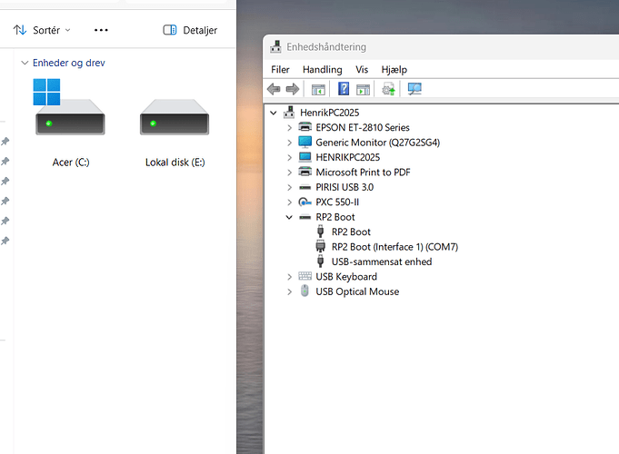

Arduino Nano RP2040 connrct can't be seen in explorer, but can be seen in device manager?
I have followed the guide for Arduino website, very carefully, but it's the same error every time??

The error is that when I connect the Arduino Nano RP2040 to the computer via the USB port, it only opens in device manager and not in file explorer, see photo. No folder in file explorer.
I tried to install Micropython with MicroPython Firmware Installer but it doesn't work

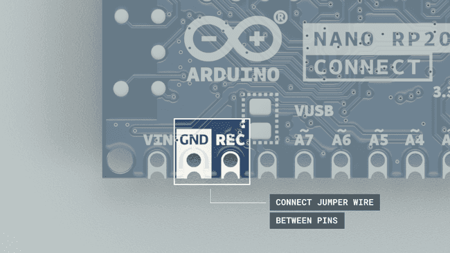

Board Not Detected
Sometimes the board is not detected even when the board is connected to your computer. This can be solved through the following steps:
1. Connect the board to your computer via USB.
2. Place a jumper wire between the REC and GND pins on the board, then press the reset button.
Place a jumper wire between REC and GND pins.
3. This will open the mass storage device. You can now remove the jumper wire.
Source: https://docs.arduino.cc/tutorials/nano-rp2040-connect/rp2040-01-technical-reference/

I have tried to do as you describe but it did not work. will only show up in device manager and not in file explorer
