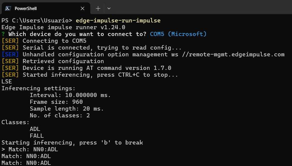

NDP.onMatch() does not work with the accelerometer sensor
Hello, I have made a model that allows detecting falls using the accelerometer values ​​as data and uses the Syntiant processing block. The model was made in edge impulse.
I made a sketch in Arduino Ide to be able to obtain the result of the inference. The code shows through the serial monitor the label that was inferred

But no results appear on the serial monitor.
Packages loaded
dsp firmware version: 19.2.0
package version: Model generated by Edge Impulse
pbi version: 3.2.3-0
num of labels: 2
labels: NN0:ADL, NN0:FALL
total deployed neural networks: 1
Configure mic
I made another model to see if it was the board that was not working correctly, this model detected a predefined word through the microphone. In this model it did show me the inference on the serial monitor
Packages loaded
num of labels: 4
labels: NN0:no_sacha, NN0:noise, NN0:si_sacha, NN0:unknown
Configure mic
Label received
NN0:unknown
Label received
NN0:noise
Label received
NN0:noise
I would like some help on how I can make the model used by the IMU sensor show the inference through the serial monitor, as I later want to send that value via Bluetooth to an App. Thank you.
