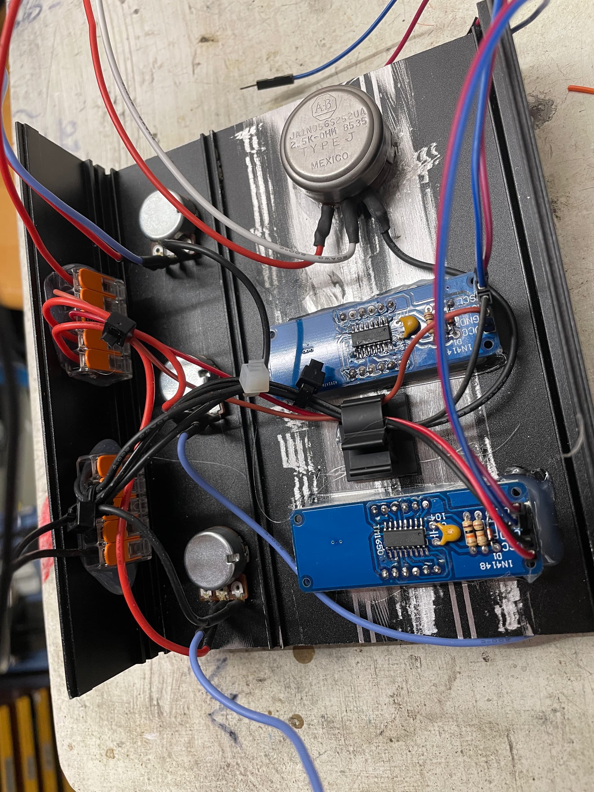

How do you keep your project boxes neat? I am currently doing a project box that 150x100x70mm that has four pots and two lcd 4-digit in the “lid” and it quickly becomes a birds nest with all the cables 😀
I am using zip ties to gather the cables the best I can but wonder if there might be some other clever devices that might help the neatifying process.
My question is not specifically about my project but a more open question so please share your ideas/tips and tricks if you want 😊

This is how it looks today
 ![bild](https://europe1.discourse-cdn.com/arduino/original/4X/8/d/b/8dbd48c910943219a0c64c70e7365edc0a4d8a66.jpeg)
This is how the lid with the pots look like:
 ![bild](https://europe1.discourse-cdn.com/arduino/original/4X/a/0/6/a06d814c791f4b1df42b02dff40609214e85ac22.jpeg)
I once tried using din rails with the smallest terminals I could find but their still way too big for a small project box. I have searched for miniature “din-rail terminals” types but haven’t struck gold yet.

I would suggest:-
1. With flying leads always have a socket at least at one end.
2. When connecting multiple wires to a component like a pot or I2C device use ribbon cable rather than separate wires.
3. Always use mounting spacers rather than blobs of hot melt glue. Save that for fixing wire routing or adding strain relief to a flexible wire soldered to a fixed post, like in a pot.
4. Just like @alanesq I have found a good box can work wonders at hiding a mess of wires. See the contrast between internal wiring and the box in this project:-
[Hexome](http://www.thebox.myzen.co.uk/Hardware/Hexome.html)
<div class="post-metadata">
**Author:** ![Paul\_B](https://dub1.discourse-cdn.com/arduino/user_avatar/forum.arduino.cc/paul_b/32/216376_2.png) [@Paul\_B](https://forum.arduino.cc/u/Paul_B)\
**Post date:** [November 7, 2021, 7:26am UTC](https://forum.arduino.cc/t/neatifying-project-boxes/922530/8 "2021-11-07T07:26:07Z")
</div>
I am forever posting on this subject. 😁
You are referring to neatness. There is a more important aspect, which is **reliability**. Open loops in the wiring can and will function as coupling inductors from one part of the circuit to another. These microprocessors are operating at **radio frequencies**.
While I see some heavier wires in your device and have no idea what it is supposed to do, I see connectors to external devices which **may** switch significant currents. The overall rule is that both or **all** connections from each part of the circuit to another must be bundled **together** , with no single "flying" connections to a separate part.
Both power connections, supply and ground, must **always** travel as a pair and a signal connection must travel together with its ground. If both supply **and** signal connections run from one part to another, all three (or more) must be bundled.
Once you actually follow that rule, the wiring **will** be neat. 🕶
