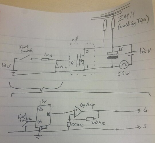

I have constructed a spot welder from a very large capacitor charged by a car battery, that capacitor is shorted across a pair of copper welding tips to fuse nickel strips to 18650 cells. I am currently controlling that shorting by means of a switch formed of 8 IRF1404PBF, they each can handle a hundred amps, so between 8 of them I'm able to dump a few hundred amps from the capacitor for a few tenths of a second.
I switch on the IRF1404PBF, by means of separate 12V battery which is operated by a foot switch and is applied to the fets thus dropping their resistance to tiny amounts and allowing the violent welding current for a moment.
The issue is that I can't control how long the short is allowed to occur for very accurately. With a momentary tap on the foot pedal I can see (on oscilloscope) anywhere between a couple of microseconds to half a second and the weld goes from nothing, to good, to vaporized in that time!
What would be great would be to trigger an arduino with the foot switch and then some code respond, hold an output high for a controlled number of microseconds and thus 'turn on' the fets and pulse the welding current in a controlled way.
Trouble is I need about 12V to do this. Would a non-inverting opamp circuit work to step the arduino output up to the required voltage?
I drew a circuit diagram and attached, I think. Kind of. Apologies - its probably nonsense!!
Top is working if inconsistent welding circuit. Foot switch driven by small battery puts 10V via a voltage divider across the GS of the Fet and hence allows the capacitor to discharge briefly across the welding tips.
Bottom is me suggesting replacing the foot switch and voltage divider with: (an unlabeled for some reason - sorry) arduino. The foot switch informs an i/o pin on the arduino (set as input with pullup turned on) that I require a pulse. Code would then set the i/o pin on the right high at 5v and the op amp amplify to 12V which is wired to the gate (and source).
  • Does that sound stupid / insane / foolish?
  • If not any recommendations on op amp chip?
Apologies if it seems very naive and if my diagram is unintelligible.
Thanks,
Danny
Opamp is possible but complex and not ideal can't output a lot of current). Because you want rapid turn on/off I would just go for a mosfet driver IC.
And about the multiple mosfets, do you use balancing resistors for them? Otherwise there is a change the current will just pick the mosfet with a tiny bit less Ron to do 90% of the work. Although a single IRF1404 can do 800A pulsed already :slight_smile:

You're just kidding yourself if you think you can build a proper gate driver circuit from parts on hand, especially op amps. You've said the cost isn't as important as making it work so spend a Buck/Euro/whatever and buy a proper gate driver IC.
Thanks for the rather curtly expressed advice!! A rather friendlier chap suggested that and I've spent a little while researching and have ordered one :slight_smile: Can I suggest a tad less coffee, or a bit more, or maybe a bun with some icing or the like? I find old episodes of Frasier cheer me up no end.
