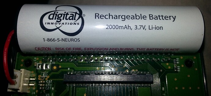

This one is 65mm long x 18mm diameter, JST type connector is 2mm pitch.
Its a 18560 cell, very common type of LIPO battery.

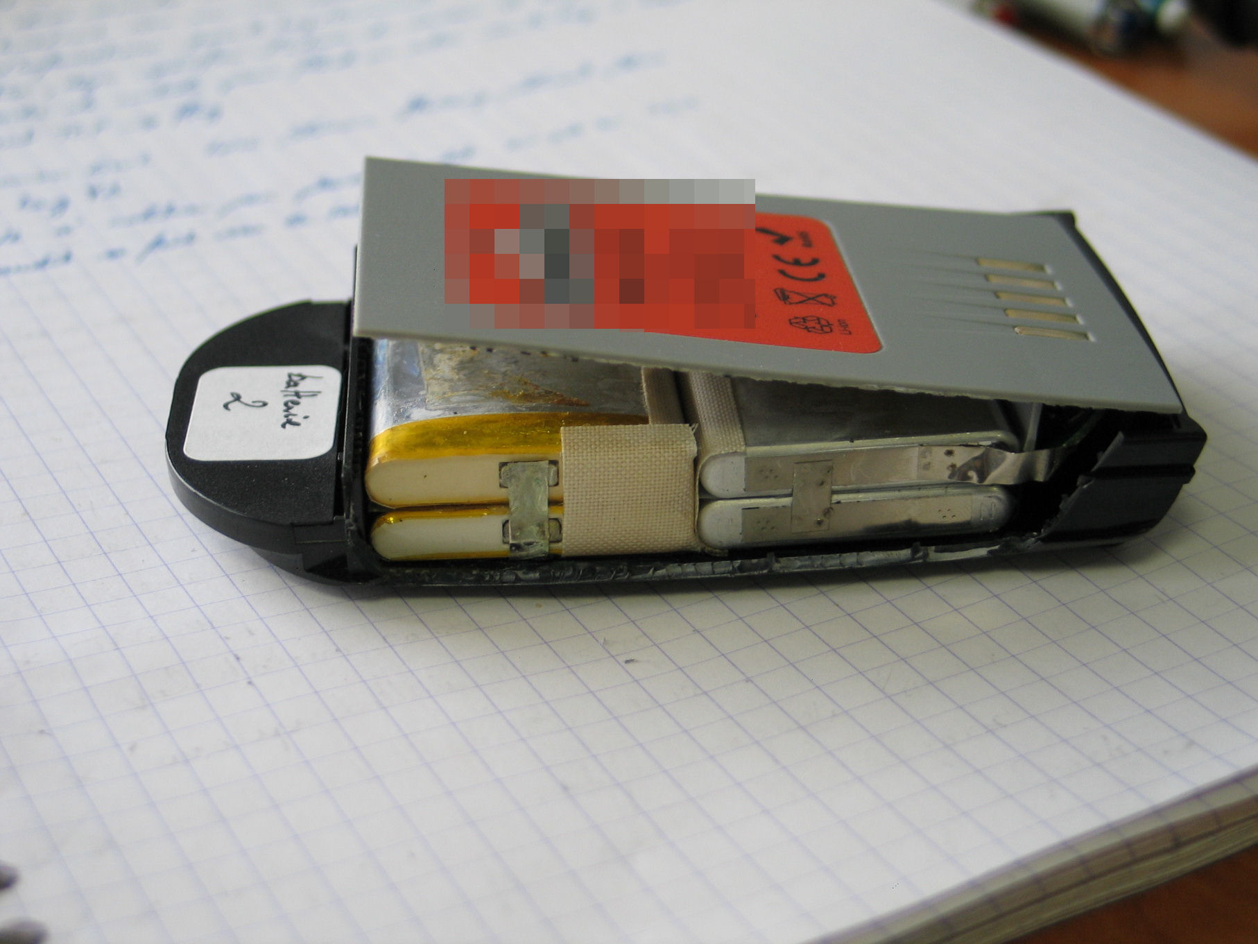

and even with that, the chemistry can cause some problems. here is a pack I've got from customer.
bad spot welding causes chemistry to fail and cell thermal runaway.

Older MP3 player (Neuros Audio) the battery came from has charging circuit in place already. I have 3 of them, one at work, one at fencing club, one inmy basement.
Only issue is that if power plug is attached, unit assumes power is being applied - and if its wallwart is unplugged or the powerstrip it is plugged into is turned off, it drains the battery. Done enough times, it kills the battery. Could just be old battery too, these players are like 8 years old. 80GB hard drives, still play great. USB2 interface, takes ~1 sec/song to load new music. (~8 MB/song, sampled at 256K dual stereo). 30mW output, plenty of volume.
