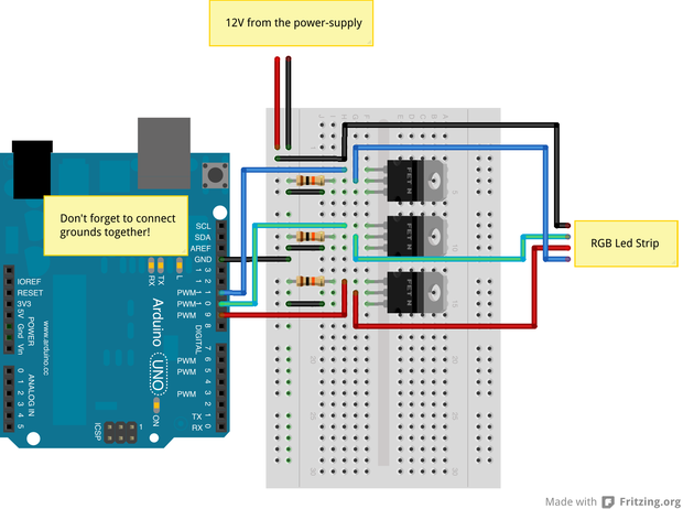

I believe you want what is refereed to as a color organ, here is a link you can check out. [https://www.instructables.com/Arduino-Color-Organ/](https://www.instructables.com/Arduino-Color-Organ/)
 ![image](https://europe1.discourse-cdn.com/arduino/original/4X/5/3/2/5327dbf7fbe49aae5042cff6415b06c9201aac02.png)
