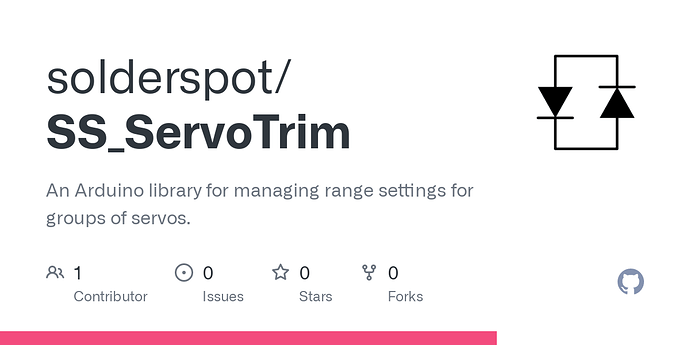

BTW WorldWiz, as you are controlling so many servos and you'll probably need to be able to control the speed of each, you might be interested in these two libraries I've recently written:
https://github.com/solderspot/SS_Servorator https://github.com/solderspot/SS_ServoTrim
Not sure what your programming level is or if you have installed libraries before but these might save you some time.
I created the libs as I'm working on animating a robotic arm that uses 6 servos and I needed speed control. I'm using Adafruit's 16 channel servo shield which I've written about in this blog post: http://wp.me/p493sy-2u. It might also be something you are interested in using as you can stack two of them to get the 30 servo controls that you need.
