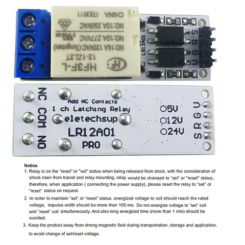

Hello All;
I am having some difficulty with a latching, dual coil relay. I will be using this relay to turn on a gas heater. In the future, this logic will be incorporated into my thermostat control project, but for now I am only doing a proof of concept with the relay, using a push button for the control. The relay is question is a **Eletechsup LR12A01 Pro**. There are four pins on the control side (VCC, GND, RESET, SET) and three on the output (NO, COM, NC). Here is a picture:
 ![LR12A01 - B](https://europe1.discourse-cdn.com/arduino/original/4X/0/f/b/0fbec8b2a474fe385c6efae908a3885d9ced6329.jpeg)
Here is a link to their product page, including a downloadable datasheet: [LR12A01 DC 5V Magnetic Latching Relay Module](https://485io.com/motor-driver-board-c-28/lr12a01-dc-5v-magnetic-latching-relay-module-bistable-selflocking-flipflop-latch-switch-board-for-arduino-esp32-p-1229.html)
I have this connected to an **ESP32-C3 Super Mini** dev board. I also have a single push button which will pull a pin to ground on activation. My problem appears to be that whenever I have both the SET and RESET pins connected to pins on the ESP32, they are locked in a fight with one another. It's as if they are both attempting to SET or RESET the relay at the same time.
However, I can manually SET and RESET the relay by grounding the pins one at a time. When I do this I can hear the relay click, so I know it's working. To be more accurate, I can touch the pin of the one not last "clicked" with either GND or VCC to hear the relay click again. I suppose those pins are just looking for a change in the voltage, but I am not sure.
I scraped together a very basic sketch that I derived from others in the forums (and greater Interwebs). I have tried every combination of pulling the pins HIGH and/or LOW to trigger the relay, during both the initial void Setup() routine and my button's click event but have had no success. I should point out that occasionally the button click event does not register (i.e. I can see the Serial output had not updated). I think may have something to do with the SET/RESET fight I mentioned earlier, but perhaps not.
Could someone please look at the code below and tell me if I am making an obvious mistake?

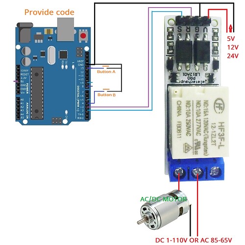

I don't have any latching module to test with, but just to start from the beginning: did you ever have a look at the Arduino sample code and diagram (where's yours?) included in the manual, and tried it to check if it helps in any way?
I mean this diagram:
 ![Wiring diagram](https://europe1.discourse-cdn.com/arduino/original/4X/3/0/7/307097518ca76f2b6d5388c4a85f779c71ae3e8f.jpeg)
and this code:
```arduino
int INA = 3;
int INB = 2;
int buttonA = 13; //Set Button A as blue button, connect to Pin 13
int buttonB = 4; //Set Button B as red button, connect to Pin 4
  pinMode(INA, OUTPUT);
  pinMode(INB, OUTPUT);
  pinMode(buttonA, INPUT);
  pinMode(buttonB, INPUT);
  if (digitalRead(buttonA) == LOW)
      digitalWrite(INA, HIGH);
      delay(100); //100ms pulse signal
      digitalWrite(INA, LOW);
  if (digitalRead(buttonB) == LOW)
      digitalWrite(INB, HIGH);
      delay(100);//100ms pulse signal
      digitalWrite(INB, LOW);
PS: the only thing I'd change, I think an INPUT\_PULLUP for the buttons should be used..

Hi, Docdoc!
Thank you for the reply! I currently have the relay being powered by the 5v pin on the ESP32-C3 Mini. Your diagram appears to be using a separate 5v supply from elsewhere. That seems like a good place to start.
The code you posted is very similar to my own, and I think I have already tried this exact snippet in previous tests.
I have another relay (non-latching) that I was able to flip flop back and forth using a single output pin from both the C3, as well as, a ESP-WROOM-32 dev board. In that case, I only had to ground the RESET pin to toggle. Maybe my new relay is not as tolerant. 🤔
I will give this a try and report back. Cheers!

Hi, Paul!
I currently have the relay connected to the 5v line and a ground pin on the ESP-C3. The SET and RESET pins are connected to pins 6 and 7, and they are configured as outputs.
When I was performing my goofy manual test, I was connecting the SET and RESET pins to a GND and 3.3v rail coming from the ESP. The relay flipped and flopped when doing this. I believe I also tried a 5v source and it worked as well.

From the relay data sheet we can see it takes 90 mA current to trigger a set or a reset. The outputs of your ESP32 can't supply that much current by themselves. Do you have any NPN transistors that you can use to build a small circuit to supply the proper amount of current?

That seems to confirm my theory
> [@PaulRB](#):
> I'm wondering if a 3.3V level, being less than 5V, is low enough to flip the relay.
Your relay module contains opto-isolators (those black components with 4 pins each). It would seem that the (5-3.3)=1.7V voltage drop across the opto-isolator's input is enough to trigger it, which in turn triggers the relay (via those transistors, the small black components with 3 pins each).
When connected to a 5V Arduino, when the output pin is HIGH, it would output 5V, so the voltage drop across the opto-isolator's input would be 0V, so it wouldn't be triggered.
You don't need to abandon your ESP. You just need to add a couple more transistors to overcome the unwanted triggering problem (and protect the ESP output pins from damage due to being connected to 5V).

Happy days! My code is now WORKING with the substitution of my ESP32-C3 with a **5V Arduino Nano**. At least it appears to be for now. The problem must have been the under-powered ESP pins.
My attempts at testing with an external 5V supply did not proceed as my cheapo breadboard power module had a faulty 5V rail. I will, however, try this once I source another supply. I read in multiple places that separating the MCU supply from the relay (then tying the grounds together) would be a more prudent move (as illustrated in @docdoc 's schematic above).
I haven't yet given up on the ESP32-C3 for now. I may not be able to drive the relay with it but I can still use them to pass the sensor data and perhaps send a signal to the Nano to flip the switch. I may even use @jim-p 's transistor trick, once I get my hand on some.
Very many thanks to ALL of you who participated in helping steer me to the correct solution. That was very kind of you. This was my first post, so you have my apologies if the threads seem to jump around. I haven't quite figured out this formatting business.

You were right about those opto-isolators. I googled the part number and that's sure what they were. I am going to proceed with using the Arduino for now but will hopefully return to the ESP once I get my hands on some transistors. Thanks for your help!
