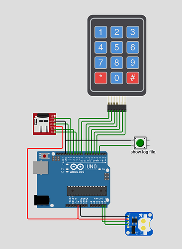

Ok so i got another project in mind just need some help and to be steered in the right direction, got an arduino uno that i want to hook up to a key pad 4x3 3 length and 4 down, i simply want to be able to enter a 4 digit code and have it stored to an sd card, i don’t think the Arduino board has enough storage, also want to make this portable thats why i chose the arduino nano, is there something smaller or something better lmk thanks for the help

See man your right on it, its my fist time doing a project so im new, bought some osoyoo lgt nano comatible with atmega328 off amazon, have the basic set up the arduino nano and the 3x4 key pad have them hooked up and have the basic code i pulled off online, it all works numbers show up and all, now like you were saying yes its like a logs of passwords 4 digits long, no more than around 1000 4 digits codes, i just simply want to be able to input a 4 digit code and when i press # pound it saves it to the arduino nano its self or an sd card were i can access it later any time i need and yes time and date would definitely help didn’t even think of that
so it seems you need to work on your requirements
Saving the time in the log will require access to an RTC of some sort
being able to access later on the data means you need to define how this is being accessed , may be a button to dump the file on the serial monitor
it's not difficult to patch all this together based on existing libraries

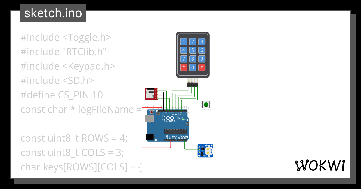

here is an example in a simulator
click to see the code

Bro thanks so much you definitely steered me in the right direction, instead of that big nano uno im gonna use the nano, if i make this portable will i still be able to hook up to my laptop and then press the button and be able to see all the 4 digit code recorded
