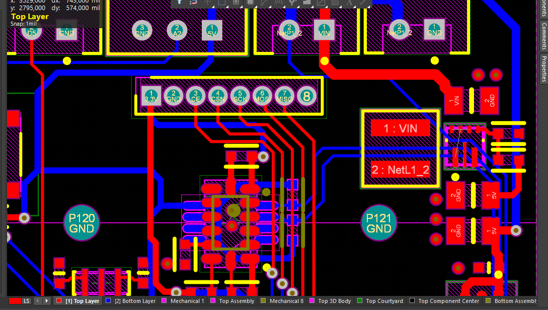

This PCB is designed for a device that includes a set of sensors to measure vibration, temperature, and current in industrial electric motors. Initially the prototype used an Arduino Nano, but now the PCB has been created to fit inside a box with all the necessary chips integrated in one piece. However, we are experiencing problems with data recording due to the lack of pins for serial and SPI communication.
We considered using the nRF24L01 connections, but the SPI pins were incorrectly connected to the MISO1, MOSI1 and SCK1 pins, instead of their corresponding 0 pins. Also, the bus intended for serial communication was connected to the MOSI0 and MISO0 pins, instead of the intended RX and TX pins. These design errors made it into the final PCB and now we need to find a solution to load the codes without losing the lot of parts.

Your schematic doesn't seem to match what is shown in the picture of your board,
So it's difficult to know if what you are doing is right or wrong?
I see from the video you needed to do some hacking for the SCK and RESET connections.
Hi, @Matheus_Markies
Can you post some jpg EXPORT images of your PCB from the CAD please.

Not sure what pin 5 would be. But you can use SCK1 instead of 5, hook up your LED plus resistor to the NRF's SCK pin and check if that works.
const int ledPin = SCK1;
I`ve spotted something suspicious on the schematic, the caps around crystal , (C1 and C2) should be around 22pF not 10uF.
