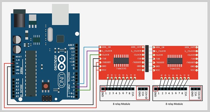

I´m planning a new project where I need to control 16 I/O buttons.
So I decided to use 2 shift registers 74HC595 (breakouts) + 2x 8 relay modules.
Because I´m pretty new to this electronic world I went through different tutorials. But I´m still confused how to connect all together.
Connecting Arduino to first shift register:
http://bildr.org/blog/wp-content/uploads/2011/08/shift-Register-breakout-hookup1.png
The second shift register is no problem too. I set it parallel to the first one and connect it.
I bought 2 of the following 8 relay module:
Each shift register has 8 outputs so each shift register will be connected to one relay module.
But what ground and VCC?
I will run the 8 relay module with seperated power supply so the arduino doesn´t need to power supply the relays.

How are you reading the buttons? The '595 shift registers do not come into play there, do they?
Connect the control side ground of the relay card to the Arduino & '595 GNDs. They all need a common reference point.

I´m not sure what u mean. "Reading buttons"?
Here is a better picture how it should be connected.
But I don´t know where to connect the read marked pins.
I think I´m only missing the how to connect the GND from relay module and where to connect the power supply for the relay module
Do NOT connect relay ground to Arduino ground.
If you do, you don't have opto isolation.
Remove the JD-VCC jumper
Connect relay VCC (next to input 8 ) to Arduino 5volt.
Now you should be able to activate the relay indicator LEDs by writing LOWs to the pins.
Connect a separate 5volt supply to JD-VCC and relay ground.
The same relay supply can be connected to the second relay board's JD-VCC and ground.
Those relays use 75-80mA each when active, so use a 5volt/1.5Amp (minimum) regulated supply.
A 5volt tablet charger might do.
Leo..

Thanks for your fast reply.
I adjusted my painting.
I hope everything is ok now.
Diagram seems ok.
