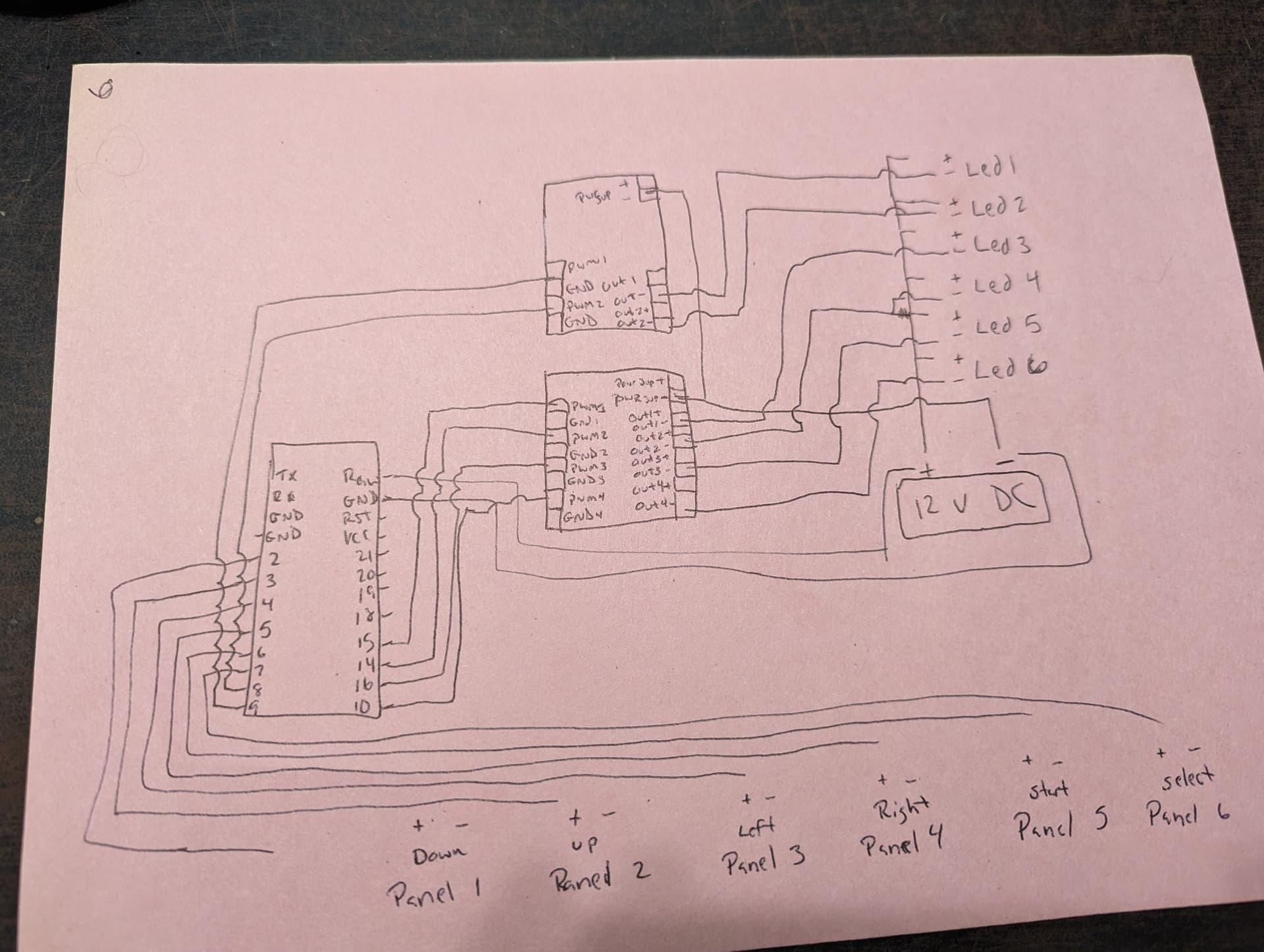

Need help correctly wiring an arduino micro pro with 2 octocoupler isolators
I am trying to follow the directions on this post to wire up a dance pad and I am struggling with the directions that he provided. The issue that I am having is for the LED Version 2 controller he just says to wire them together but that doesn't help me. The pictures that are posted are all of the V1 setup not the V2. I have a few questions on the LED controller, 1, I don't know how to power the system properly. I have a DC power source of 12V, 3A which I can run but dont know the right way to, secondly I would hope that I can power the arduino with the same power source that I am using for the Isolators. I have attached a diagram which I think is how it is supposed to be wired according to what the guy was saying in the instructions but I feel like I am missing something. I feel like I am grounding out something wrong because nothing seems to be working and my power just disappears somewhere in the circuit.
Hi and welcome .
Unfortunately a lot of stuff on instructables is not well designed , complete , and in a lot of cases doesn’t even work .
However a few more details might help - what are the leds for example , put the code up here ( use the code tabs ) . It might also be worth asking questions to the author .
Also useful to know your experience with Arduino .
Sorry not a very positive reply , but this is a difficult one . Hopefully some other comments will turn up
Well done posting a circuit diagram !
The link on the web site doesn’t open .
I will try to explain what I have going on and some pictures, I will also add the code too. So the dance pad is like what you would find in an arcade with the addition of the top left and right panels for start and select. I have built the thing from scratch and 3d printed the parts that I needed, the intent is that when you step on the pad the controller sends a signal to the computer it is plugged into to show the pad was pressed. I also want the pad to light up when it detects a press. I have color coded the wires to correspond with each pad. After thinking about it I believe that I have the ground not set up properly because I tied in the sensor ground and the light ground to the same ground line. I was also mistaken at the mosfet, ignore all the black wires coming out of them because I was just getting frustrated at that point. I know the electricity from the DC 12v power source is reaching the Arduino and if i take the + and - from the DC straight to the Arduino it turns on but when I try to run the ground it will not turn on, for the Arduino micro pro that is shown in the picture, I have the 12v running to RAW, a ground line ran to the ground pin. then the down panel to 2, up to 3, left to 4, right to 5, start to 6, and select to 7. I have tied the sensor lines to these (might be a mistake) Then I have pins 8, 9, 10, 16, 14, and 15 all going to the Mosfet PWM ports (I think I need to run the ground pins back to the Arduino here instead of back to the DC power source but at the moment they are tied into the common ground) The sensor pad lines are not connected to the other Arduino micro pro yet because I hadn't gotten to that step because I was struggling with this at the moment.
