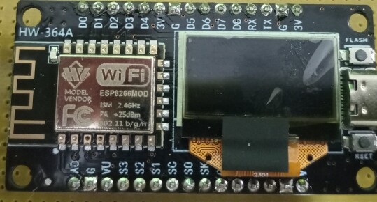

Hi all!
im new to ESP and i want to display current value on display of oled display. code is working fine but when i use display library like (u2g8 or SSD1306) it will trigger software watchdog timer.
here is code:

IMG_20240922_203227_532
can anyone help me in it thanks!
Your topic has been moved. Please do not post in "Uncategorized"; see the sticky topics in Uncategorized - Arduino Forum.
It appears that some of the code in the library is blocking. On the ESP8266, your code runs as a task within its multitasking environment. The ESP8266 has two watchdog timers: one implemented in hardware and another in software. The following links will help you understand what is happening:
https://sigmdel.ca/michel/program/esp8266/arduino/watchdogs_en.html
yea it might causing problem , is there any way out i can try
