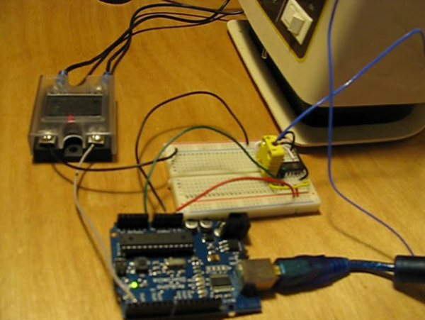

So i have a school project i am doing i am trying to replicate this guide i found in this site Arduino Playground - BarebonesPIDForEspresso
and i am having some issues, my thermocouple is not givving me correct tempratures, for instance when i put the thermocouple in boiling water i get 120-130 F, if anyone can help my i would apreciate it. Any information you need about my thermocouple or anything else just let me know

This is the thermocouple i use, with a ad595 amplifier and an arduino uno

This i exactly how i have my arduino set up, the only difference is the thermocouple

That is what i've been trying to do, i stabilize to around 100F cause the only thermometer i have around has a max of 120F but when i try to read high temperatures like boiling water i get temperatures from 120 to 130F on the PID
i think i have found the issue but have no clue as to how to fix it, seems like the ad595 amplifier also has a "thermometer" on it and its reading the ambient temperature and lowering my thermocouple readings. When i rub the amplifier with my hand the temperatures start to go crazy as shown in the photo, is there a way to stop the amplifier from giving its own input ?
