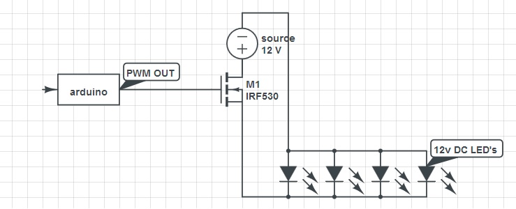

Please excuse my attempt at a diagram. First time doing one. I did some research and if I am understanding things correct. This is what you mean by using PWM from the arduino to a N-Channel MOSFET. Sorry if this is a bother i am trying to better understand more of how this all works.
Excellent diagram but polarities and some more need to be changed.
An N-channel logic(!) MOSFET needs to handle the low side of the load, the LEDs. The 12 volt GND must be connected to the Arduino power supply GND.
Okay, I think that I may have this. Please correct me if i am wrong. This is the new diagram i came up with.
That's much better but remove the ground connection of the rightmost LED! That would make the PWM useless and LEDs shining at full power.
I hope each LED represents a strip containg the neccesary resistors, or other current limiting.
I did not realize that I had that ground there still. I did know that one. The LED's are 12v so do i need resistors? wouldn't the PWM from the arduino be responsible for dimming the LED's?
Add a 180 - 220 Ohm resistor between the Arduuino and the transistor!
You alse need to change to another type of MOSFET. You need to use a logic N-channel MOSFET, not a "common" MOSFET! The gate - source voltage needed is too high for the IRF530. You've only got 5 volt there.
A naked little LED must have a resistor that limits the current. That's likely built in in the LEDs You use.
Yes. PWM stands for Pulse Width Modulation. When the controller pulse goes positive the MOSFET will conduct and let the current flow as long as the pulse is positive. When the pulse goes to zero the current is switched off. The normal frequency of the pulses is some 490 Hz. A wide pulse, or HIGH all the time gives full light. Shorter pulses reduces the light. That's the nature of dimming using PWM.
That was the MOSFET the program I used to draw the diagram with had. I did not change the naming of it to what I was going to use. This is the one I was planning on. By the way thank you so much for all you help.
That looks perfect. "Logic Level N-Channel Mosfet" is the correct name, "logic level"! They turn fully on from the 5 volt issued by the Arduino.
