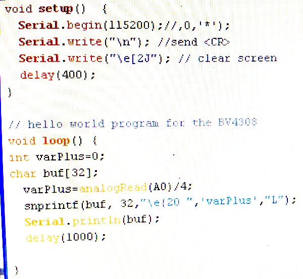

Need help! Txt+variable+txt to serial txt?
I have a serial tft color display ( Byvac BV4629/lenny).
It uses VT100 commands to draw lines pixels etc.
Now i want to dynamicly change the value off the command send.
I added a picture of what i came up with.
Allthough this code just prints out {20 over and over.
It stops right where the variable is...
Any help is appreciated!
Why is "varPlus" in single quotes?
Why are you posting a JPEG when you could post code?
The format specifier looks really strange to. There should be one % sign per variable.

Where did you get the example for snprintf?
Post the actual code, inside code tags (not a screenshot). Then we can all see it and copy and paste snippets.

here is the code i'm using:
void setup()  {
  Serial.begin(115200);//,0,'*');
  Serial.write("\n"); //send <CR>
  Serial.write("\e[2J"); // clear screen
  delay(400);
int varPlus=0;
char buf[32];
  varPlus=analogRead(A0)/4;
  snprintf(buf, 32, "\e{20 ", varPlus, "L");
  Serial.println(buf);

iSpider:
That is just printing "\e{20 " - the arguments varPLus and "L" are unused because the format string does not include any format specifiers.
If you wanted to include the value of varPlus in the string, you could do it using something like this:
  snprintf(buf, 32, "\e{20%dL", varPlus);
The %d in the format string is replaced by a decimal representation of the value of varPlus.
YES YES YES YES!!!!
It's working now! Thank you so much! i have been breaking my head over this for over a week!
thanks again!
Here is the working code:
