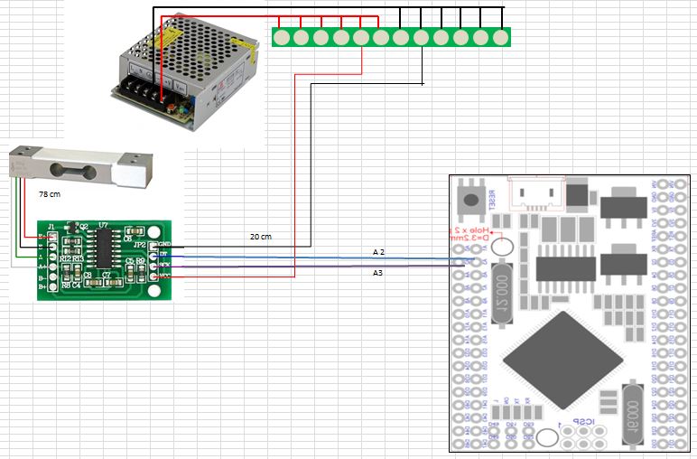

Need Help, Weight Chain
Dear ALL, I'm very new on arduino :confused: ,
I need help to solve at my project.
Description on my project
I use load cell, motor stepper (to move chain), motor servo (to reject product), LCD, Keypad
and the Function
If I push button "A" Motor running
If I push button "B" load cell Weighing after 2 second arduino will decided good/bad product and send order to servo to move from position 0 to 90.(problem motor servo can't hold position at least 2 second) another problem how to make motor stepper move after 2 second arduino decide good/bad product)
Problem:
  1. How to show up the text on LCD while i turn on the motor(Fyi, i already try to combine on void motor i input "program LCD" but the result is LCD blank and motor run very slow?
  2. How to make servo at pos 90'(bad) little bit hold the position while we push the product?
  3. How to make stepper move while arduino decide product good/bad?
Thanks
Best Regards
Doni
this is the program:(i combine all programs as possible)

I would use "flags" to syncronize the project.
bool servoRejecting = false; // servo reject flag, to prevent stuff from happening while rejecting product
uint32_t servoRejTime = 0; // to keep track of rejection time
uint16_t servoRejLimit = 2000;
in your void loop()
{ Serial.println("bad");
servo.write(90);
servoRejecting = true;
servoRejTime = millis();
// the if-statement below is implemented as a way of prohibiting the servo to return to 0 (good).
if (servoRejecting) {
if (millis() - servoRejTime >= servoRejLimit) {
servo.write(0);
} // end loop

@doni09, you have a variable named B which seems to be important but that is a meaningless name so I have no idea what it is intended to represent. Also, don't use single character variable names (except in a FOR loop) as it is impossible to find them all with a search
You have this line
switch (customKey)
but there are no associated CASE statements
And at line 65 there is this
value from eeprom
which, I assume, will cause a compile error
And if you make changes to your program please post the revised version in your next Reply so that it can, if necessary, be compared with the original version.
...R

But i have another problem. noise from loadcell/HX711 load cell cant reach stabil , during running the reading wigth rise from 0,03-0,08 up to 0,1 until 0,2 that make the result not same on product, any one know?
doni09:
How far is the loadcell from the module and the controller?
What are you using for a power supply?
Thanks.. Tom.. :slight_smile: :slight_smile:
Dear TomGeorge,
This is the picture, please check, and for the distance already on picture. yes i use power supply. loadcell to HX711 78 CM and hx to power supply and arduino 20 cm
I hope my problem can be solved
Thanks
Best Regards
Doni Susanto
OPs circuit;
Have you got gnd of the module connected to gnd of the controller?
What model controller are you using?
What voltage is the powersupply?
Is this your complete circuit?
Dear TomGeorge,
I forget to drawing it, but connect to PSU the GND,
model controler arduino Mega 2560,
PSU is 5 V
this is not complete circuit, only load cell to arduino
thanks
Best Regards
Doni Susanto
