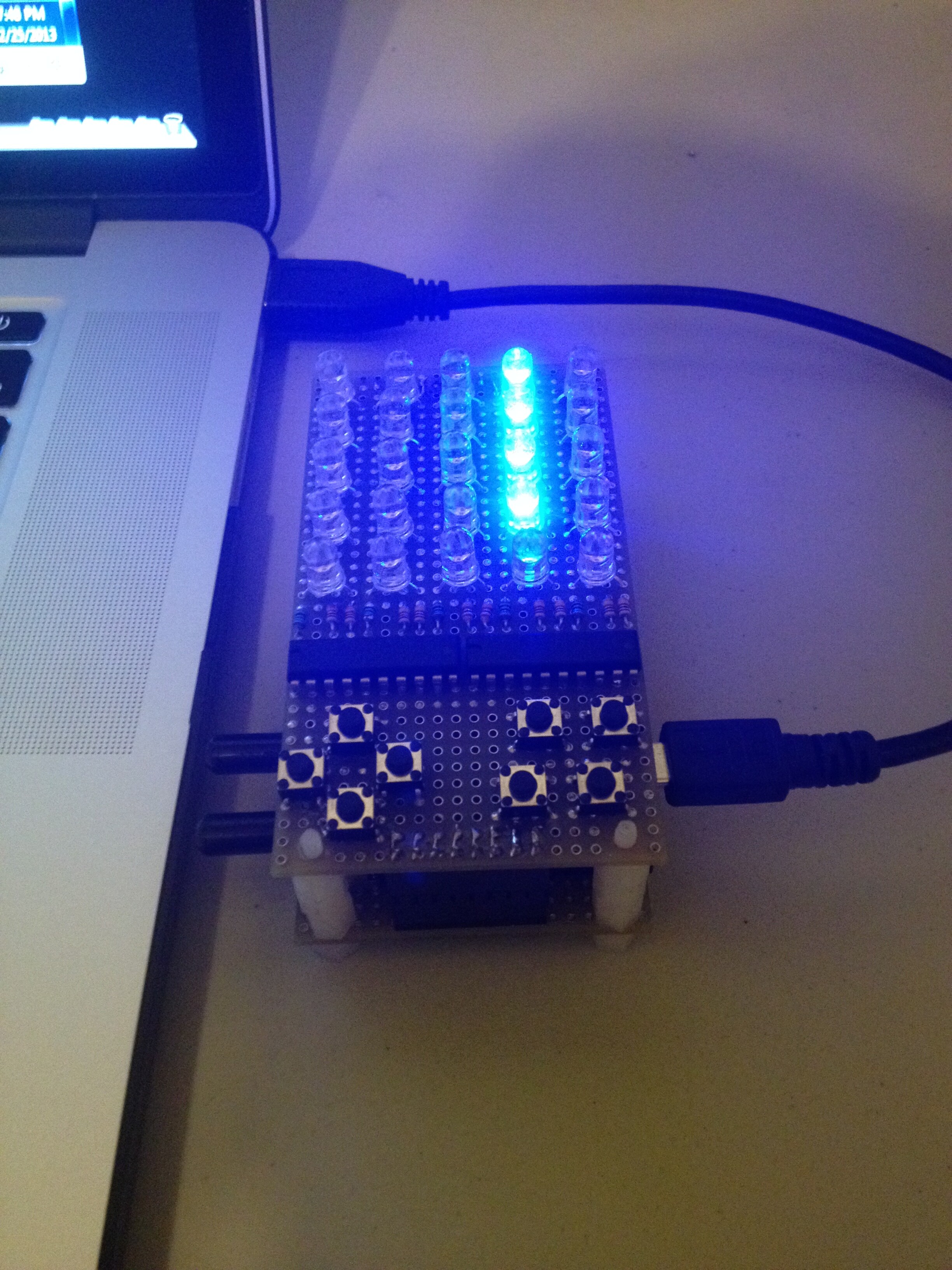

Need Help with 5x5 RGB LED Matrix Game
Once you have the multiplexing function set up, the game is then played and the display[] info updated as needed.

Yes I have made a button pad and 4 other buttons. My thinking was I would have something like a left, right, up, down, A, B, start, and select.

Okay, makes sense. Do you have a code example of something like "all 25 blue LED's on for 3 seconds" or point me to a tutorial?
Is all of 1 color on for now?
The idea is that you would change this part when you wanted to show something else:

They flicker on in every color when I turn the device on. But after that there is nothing.
Also, should "display[]" be "byte display[]" ?
I'm getting the following errors: expected primary-expression before ']' token
expected primary-expression before '{' token
expected `;' before '{' token
no, display[] is already declared as byte in the pre-setup area.
The other is a typo somewhere, figure it out. Maybe the variables not declared in pre-setup area.

I tried different things and couldn't find any typo. The Arduino editor highlights each:
"display[] = {  // '1' at a location results in an On LED, will send 1 column at a time"

Okay, little array issue.
Reloading the array the way I wrote, you need to go element by element to put in data.
If just redeclare the array, it compiles okay.
Also, added pin numbers for cathodeSS and anodeSS, 9 & 10 respectively, you had them both at 0.
Make one of them 10 so that pin 10 is set to an output for SPI transfers.
anodeSS in setup needs to LOW to block SCK from making changes to the 164's when SCK is being used elsewhere:

I was under the impression that they were the same pin number because the SS pin is wired to all of the shift registers. So "cathodeSS" goes to a regular PWM pin and "anodeSS" goes to the SS pin?
anodeSS goes to one of the DS pins on the 164's, and cathodeSS goes to RCLK on the '595s.
CrossRoads:
Okay, makes sense. There is a bit of a flicker when loading the sketch (see attached photo), but other than that no light coming from the matrix.
