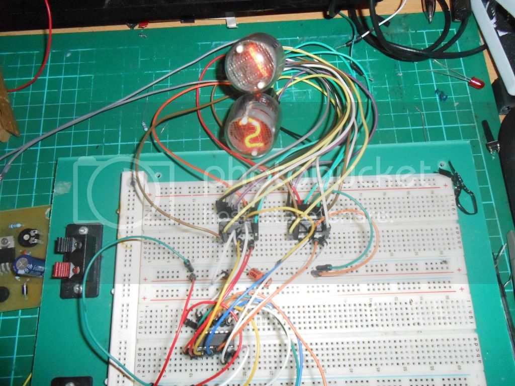

I'm trying to design a basic nixie clock with an arduino.
Some pictures of the setup.
The hardware consists of an 74HC595 shift register and two k155id1 for each of the nixies. The power supply for the nixies is based on the 555 timer and gives the required 170v.
The code I'm using is very basic which could be causing the problem I'm having.

The program kinda works , But when the nixies try to rollover from 9 to 0 there is a 5 second delay before the next part of the counting cycle continues . The counting only reaches 39 before rolling over to 0 again. This problem does not happen when digits are viewed though the serial panel so I think it might be something to do with the shift register.
I also have a video, might give you a better idea of what I'm taking about.

Thank you for your suggestion, but their is still a 5 second delay and it only counts to 39 still.
harry89:
  1. You should only need 1 k155id1 for each nixie. They have 10 outputs, and a nixie has 10 pins to define a number.
  2. The k155id1 is a BCD to Decimal decoder, and you are sending it binary. You need to convert the value from binary to BCD
  3. You are sending an int, but only a byte is being shifted out. Declare them as byte.

Thank you, That works!!. no more delays!!
Sorry error on my part the nixies have one BCD Converter each.
I thought just sending it binary would be fine, to my mind it was just a series of high's and low's.
Does this explain why it was only counting to 40 before going back to 0?
So you just add 6 onto the binary figure to convert to BCD?
I had to change seconds to 90 so it would count to 59 without going back to 0.
Thanks again!!
