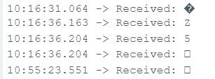

Hi, i am new to this and trying to make my Bluetooth module(HC_05) to receive any data it get from my phone through BLE using the app called "Serial bluetooth terminal " and display it onto my 2 16x32 which is in series. Whenever i sent out data from my phone the BLE module receive it but it doesn't display it onto the matrix ,even if it did it will displayed the weird character like this one �. Hope that you could help me out .

        // Debug print to see received characters
        Serial.print("Received: ");
        Serial.println(c);

This usually means the serial communications are handshaking or mismatched, if you get a bunch of them.
even though i have that , the other character should still be able to display onto my matrix but it didn't

Remove delay(): and see if that makes a difference.
now it seem to be able to display something but the outcome is not the same and the weird character is still around
Check your serial input. Make it print to Serial Monitor.
Verify ground is shared with all devices.
yep
Remove bluetooth and run the panel, with text, alone.
I have tested all of them individually and it is all working before i combine all of them together
Show the results of this. When you introduce code to a working program, you must verify the steps you take do not break the previously-working code. Arbitrary copy/paste never works.
