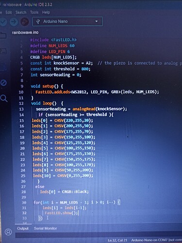

So I was trying to send pulse or a wave of light from one end to another on ws2812 led strip, everytime a button is pressed using Arduino nano.
I got it working but I was only able to send one wave at a time, I could only send another wave once the first one has reached the other end. But after struggling for a day I managed to get it to work by modifying codes from similiar projects over internet.
But now my problem is that the wave is moving quite slow and no matter wat i try I can't get it to move faster. Please help!!

Would you replace the picture/image of your IDE with the code text? Be sure to use the < CODE > button to paste the code into a code block.
Can you also show a wiring diagram?
This works (your button press is a "knock" threshold above 800 (out of 0 to 1023)
Move FastLED.show() outside the for() loop... that is to say, change this:

Yes, you (anyone) can copy the sketch. It was legible. You will note that the "show()" function was after every step in the loop rather than at the end of the loop. That is the point of my post, "Move the "show()" outside the loop.
Typing it is not copying :wink: OCR is not copying :wink:
Yes it is. The action is called "transcription." Secretaries did this all day long at 90WPM. I can only manage 45wpm... but I can also fix daisywheel printers and configure the router.
I "transcribed" the OP code and ran it in my "l a b o r a t o r y" where I found the misplaced FastLED.show().

Worked like a charm bro, that was so silly. I actually dint even knew if that matters😅
