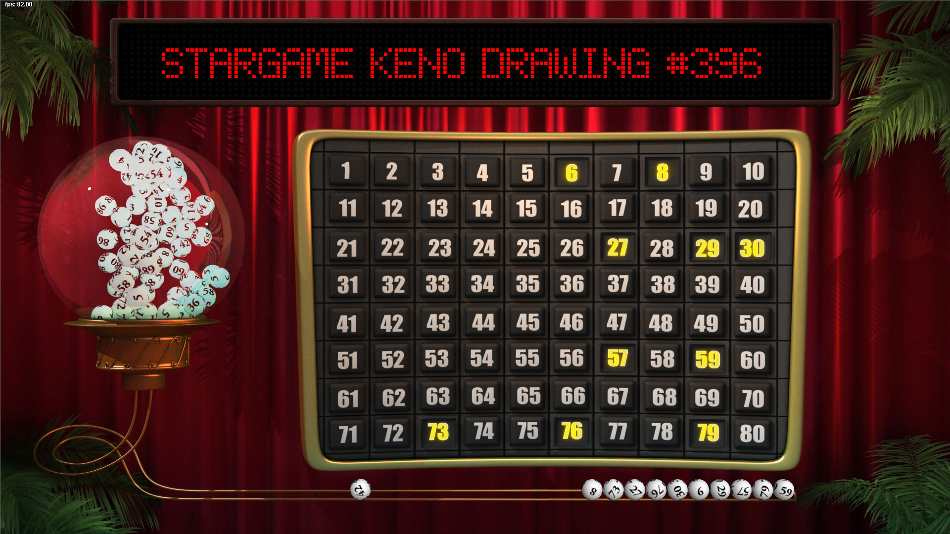

i would like to know how to connect 80 leds (bi-color) together and each turn on based on number generated.. IE, if number 12 is generated then led 12 will light up and stay lit - a delay of say 2 seconds another random number is generated - say number 4, then led 4 will light up and stay lit as well.
the only other thing that needs to be added to the code is only draw 20 numbers then stop OR delay for like 10 seconds then turn off all lit leds and start the process over..
please be clear on instructions because i have never done this before.. i don't how many chips, resistors, ect.. i need, but i do believe i have all the things needed - i gathered a bunch of stuff for past projects but have never used them.
thank you in advance,
Ruffsta
basically i want to make a keno game
sorry about the size of image..

the spacing i will be using:
so i'll need to space the leds evenly centered per square on a circuit board.. not sure if i should use a pegboard behind the above.. so wiring/connecting it all is what i like to see or focus on i never did a matrix or setup a circuit board.. but i magine it will look something like this:
correct? wish i could see how that's all connected on the back with the chip(s) and resistors.. assembling it all will be the hardest part for me. i have no problems soldering.. just how is it all connected is the issue.
