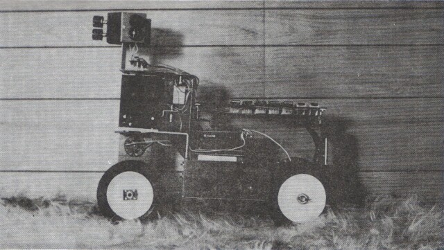

Here I was hoping for someone building a re-incarnation of Frank DaCosta's "pet" (TAB Books 1141):
Wow! A blast from the past. Thanks for the reference. You made my (nerdy) day.
