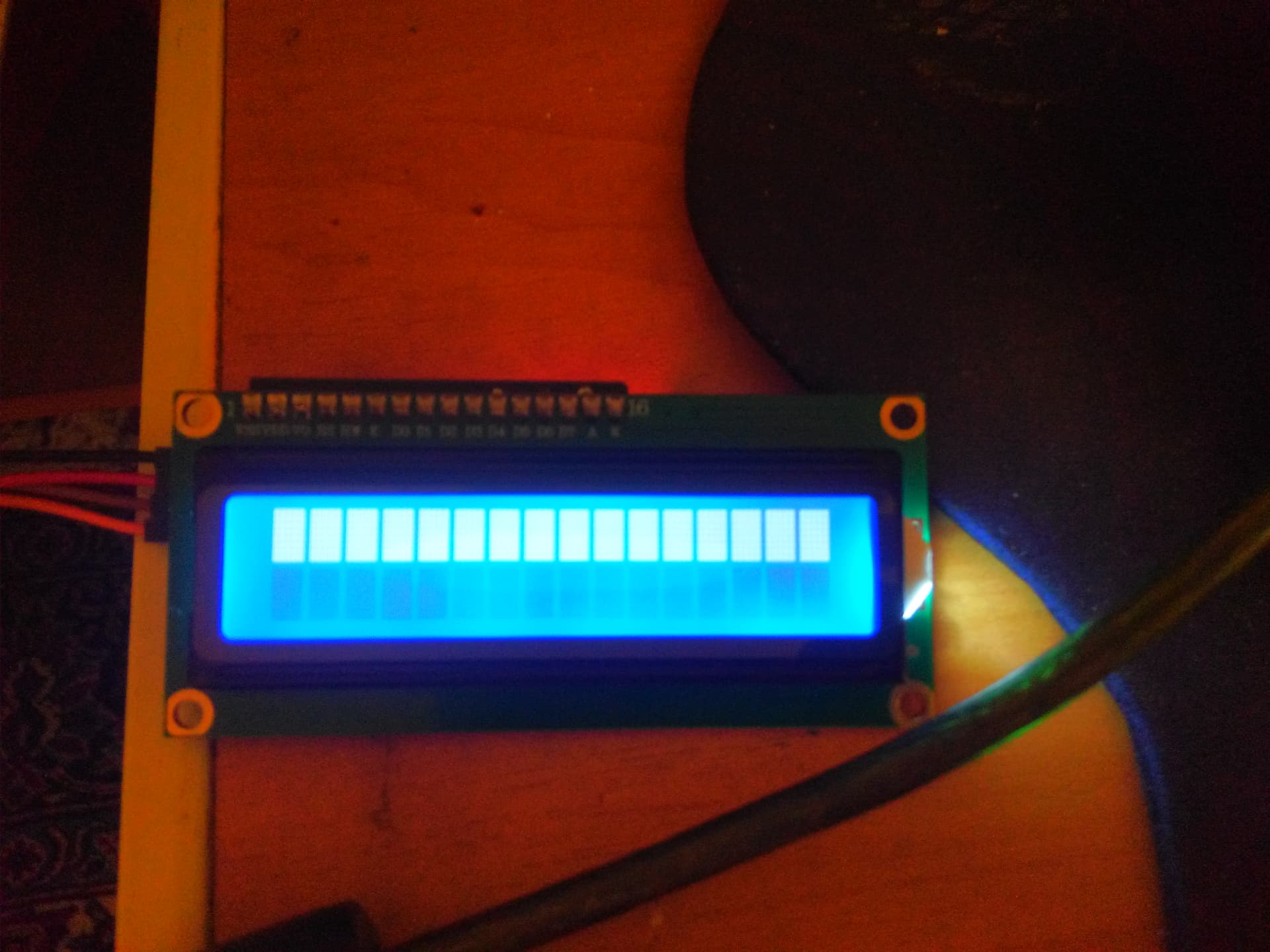

Need help with error: no matching function for call to 'DSPL::begin()'
Hi everyone
I desperately need help with this error. I've tested different LiquidCrystal_I2C libraries but no effect.
One solution I found was to put
'DSPL::begin(16, 2)'
instead of
'DSPL::begin()'
and it got rid of the error and I could upload but I get this on LCD.
LCD is fine and it can display the Hello World example from LiquidCrystal_I2C library.
Someone smarter please check the error and see if you help me, it's urgent. Appreciated.
The error message:
D:\Electronics\Hot Air Station\ARDUINO-SMD-REWORK-STATION-master\hot_air_gun_station_V1.0\hot_air_gun_station_V1.0.ino: In member function 'void DSPL::init()':
hot_air_gun_station_V1.0:403:30: error: no matching function for call to 'DSPL::begin()'
     LiquidCrystal_I2C::begin();
In file included from D:\Electronics\Hot Air Station\ARDUINO-SMD-REWORK-STATION-master\hot_air_gun_station_V1.0\hot_air_gun_station_V1.0.ino:8:0:
C:\Users\...\Documents\Arduino\libraries\LiquidCrystal_I2C-1.1.3/LiquidCrystal_I2C.h:58:8: note: candidate: void LiquidCrystal_I2C::begin(uint8_t, uint8_t, uint8_t)
   void begin(uint8_t cols, uint8_t rows, uint8_t charsize = LCD_5x8DOTS );
C:\Users\...\Documents\Arduino\libraries\LiquidCrystal_I2C-1.1.3/LiquidCrystal_I2C.h:58:8: note:   candidate expects 3 arguments, 0 provided
exit status 1

There are many different LiquidCrystal_I2C libraries; they all have different constructors and begin() methods. You need to look at the examples that come with the specific library (constructor and begin method) but I think that you have figured that out.
I can't help you further.
I figured this problem out so if anyone else has the same issue can do this:
Change this code
'DSPL::begin()'
With
'DSPL::init()'
This will resolve the error.
Have fun
You should post a direct link to the library you used.
It's solved.
Even the code's author didn't know what library he had used.
The code had other problems too that I had to fix.
