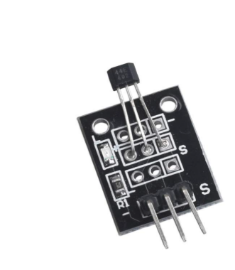

  • You have labeled the component connected to pin 4 tmp, what is this, capacitive sensor ? It is not temp but the touch sensor I have has three prongs and I couldn't find that kind of sensor on tinkercad. Below is a picture of the sensor.

  • The above is a Hall Effect Sensor, (magnetic sensor).

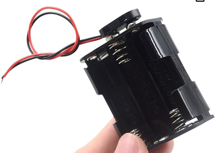

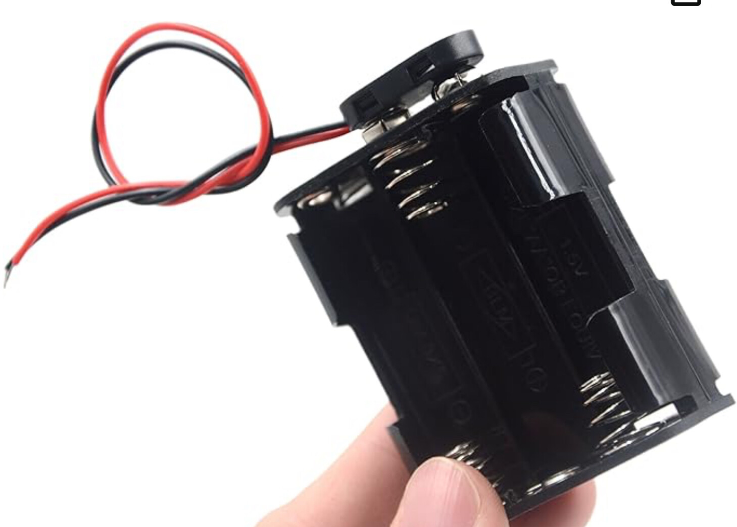

  • Use a 9v battery holder, 6 AA batteries (6 * 1.5v = 9v).
