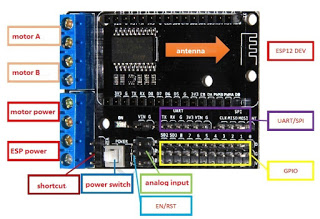

I have trouble to use the motor 28BYJ-48 with a ESP8266 NodeMCU + MotorShield ESP12E
I want to built this Project :
The main code are in LUA but; I find a another project with a Arduino Source code.
And i want to use Arduino Gui to program it.
The main program work (WebServer) But the motor don't work.
I just want to move this motor forward and reverse to start.
If someone have a code to drive the 28BYJ-48 with this pintout..this will be helpful :slight_smile: THX
I see the motor shield from China Seller can be fault
I just can't move the motor...
I LUA or Arduino

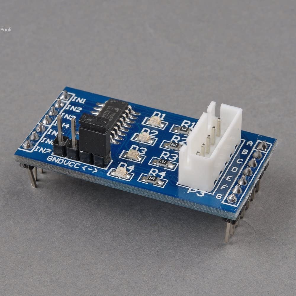

That driver is for a 4 wire BIPOLAR motor, you need one of these for your 5 wire UNIPOLAR motor.

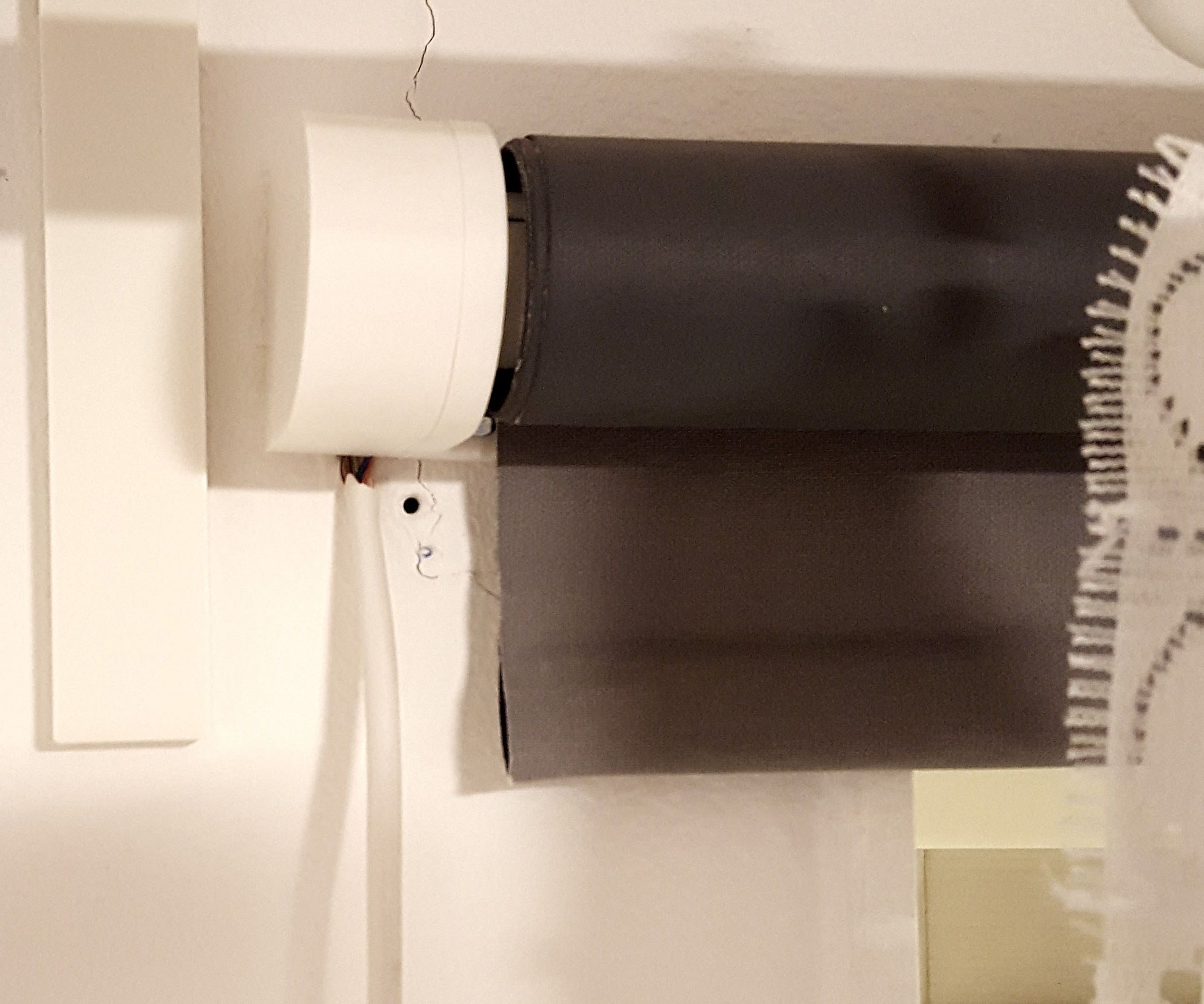

I too was aiming to make a version of the IKEA Roller Blind that the OP is referencing
...and as a software developer have taken a LEGO approach to the electronics parts, as-in: "build as in a the pictures". Supporting that with next to no understanding on what is a BIPOLAR and UNIPOLAR stepper motor.
As far as I can tell I had the same parts than in the Instructables and connected as in the pictures/videos and expected something to happen. Not so much.

This hookup works for me with an Arduino Nano.
Arduino pin 8 to In 1 on ULN2003 module, motor plugs into module socket.
10 to In 2 " " "
9 to In 3 " " "
11 to In 4 " " "
And works with the Arduino stepper library, here's the "stepper_oneRevolution" example sketch from the stepper library, modified for the 28BYJ-48, steps per revolution changed to 2048, speed changed to 8 RPM (16 RPM is about max for the 28BYJ-48 without missing steps.

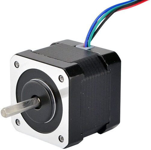

I've purchased a similar set up to what's described here and am having similar issues. The motor is not turning, but rather is emitting a faint vibration.
For testing purposes, I'm using the same sketch discussed here, Ardunio sample --> stepper_oneRevolution
The steps are set to 200 with the function call as --> Stepper myStepper(stepsPerRevolution, 1, 3, 2, 4)

NEMA 17 motor (2.2V 2A per coil):
I'm wondering if the motor needs more current that the power supply can provide?
Although, it seems like it should be providing over 2A total, given the ESP8266 power requirements are quite low. Shouldn't 1A per coil be enough to make it turn?
