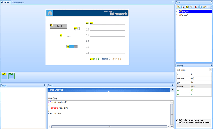

I have had a bit of trouble getting my Arduino and Nextion Touch Screen to communicate through serial without "speaking over each other", if that makes any sense. I have made a basic sketch which sends some information to the Nextion, like updating the waveform and a progress bar, but I also send variables from the Nextion to the Arduino which at the moment just changes an LED from on to off.
Previously my code was a total mess and every second command that got sent from the Nextion would not even be registered by the Arduino.
I have now gotten to the point where there is a basic master/slave protocol between the two and it is working allot better, but there are still some hiccups and I was wondering if anyone would be able to provide some help.
Here is the code for my Arduino:

The code I used in the Nextion Editor is in the attachments.
