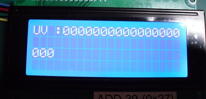

I have written a sketch for an Arduino Uno R3 + UV sensor (UVMS0A) Part myself, and part borrowed for an educational site on the web, this is the final sensor for my weather station, i have successfully read a BME 280 Temp, Humidity & Air Pressure, this would be the icing on the cake.
The problem i have is i cannot get the LCD to display the UV Index correctly, and what is displayed seems to be scrolling?i have tried many things, but now my brain is on overload. i need help with the sketch.
I have uploaded my sketch, and a j peg of what the LCD is displaying.

That sketch is very odd. You spend a lot of effort in the main loop() working out "UVIndex" and then you never use it for anything. The only thing you send to the LCD is sensorvalue and you send that every time round loop().
I have a feeling that all that UVIndex stuff should be in separate function (in which case the "return UVIndex") would make more sense). Then perhaps the result from that function should be on the LCD...but it's a bit difficult to see what on earth you were intending.

So, first i would slow your loop down so you can see what is on the lcd.
You send the raw count value from the ADC to the LCD. Does that count value look correct to you?
Your resolution is not good. Your uv index from 0 to 9 is 234 counts out of a possibliity of 1023. So I would
try to change your reference voltage to 2.5volts instead of 5.
lcd.println(sensorValue);
The LiquidCrystal library does not support the println() function. Thus the strange characters (CR/LF). Use lcd.print().

I have inserted lcd.print(analogRead(A0)); as you requested still no difference to the display read out.
I beg to differ. In the photo in post #1 there are characters with 4 horizontal lines. Those are the CR and LF characters as represented by the LCD. Those characters are not present in the photo in post #6.
There are several things wrong with the code.
slipstick pointed out that "String readSensor()" should be a function (that is called from loop).
This demonstrates the readSensor() function. I could not test with an LCD but it should work. To watch the serial prints in serial monitor, make sure to set the baud rate to 115200.

Hi groundFungus.
Thanks for the sketch, it seems to work perfectly, i have take my sensor outside and the reading is 2, the reading is stable now, no scrolling.
I have checked my local Meteorology web site, and they say the UV index is in deed level 2, many thanks for your guidance, patients and understanding.
