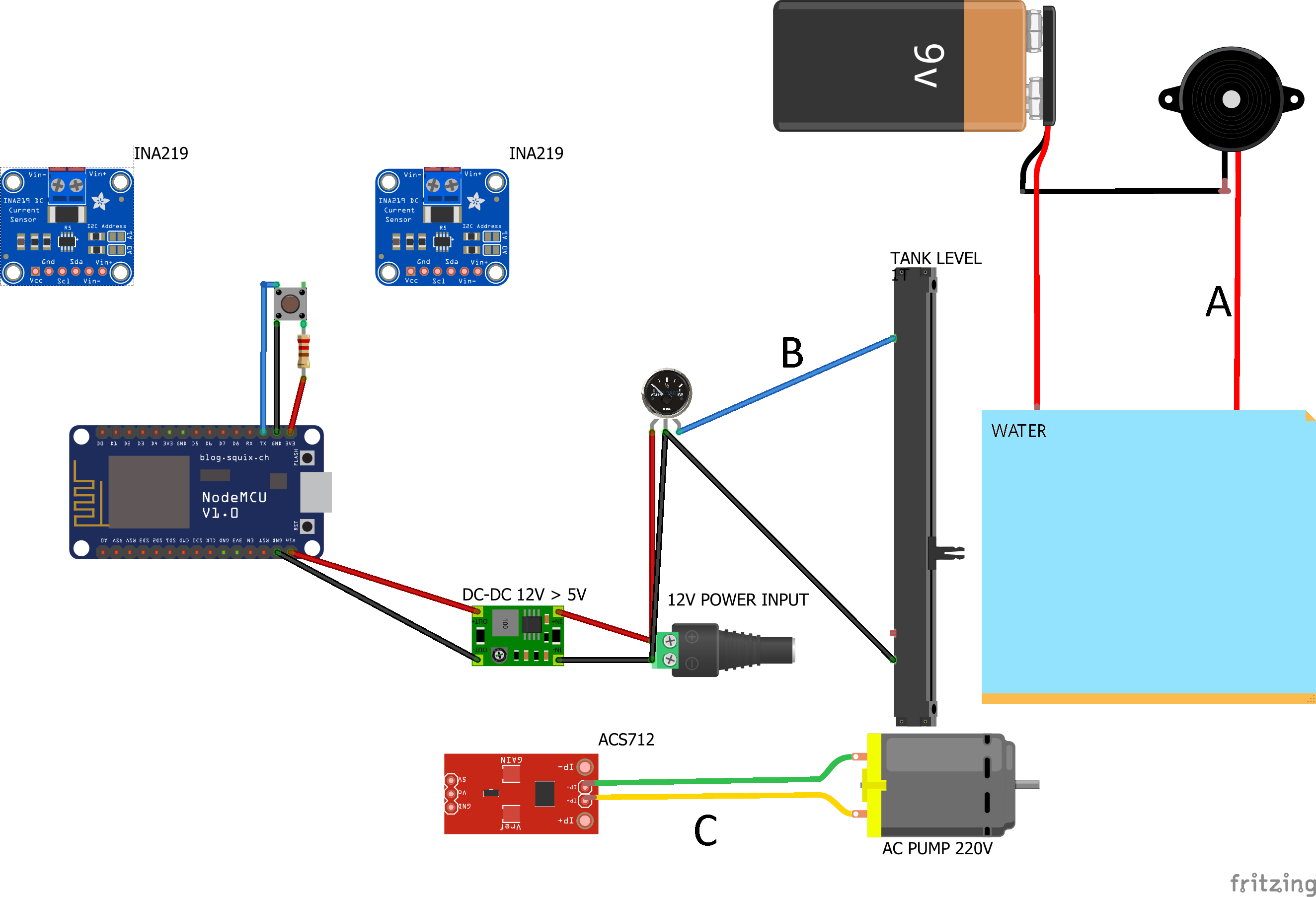

you can find the schematic attached:

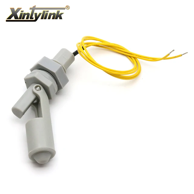

  3. the exit pipe with the magnetic switch attached
    https://ae01.alicdn.com/kf/HTB1W_.DfnXYBeNkHFrdq6AiuVXaa/1-pz-Nuovo-Grigio-Serbatoio-sensore-livello-acqua-Orizzontale-liquido-interruttore-galleggiante.jpg_640x640.jpg
  4. a very simple alarm system: if the water touches the tips of the wires, the alarm goes on. it is set at a level the water should never arrive. works with a 9v battery. wire e) is connected to battery and wire f) is connected to the alarm, when they touch the circuit closes and beeeeeeep
  5. the tank meter attached to 2) (works with 12v power supply). the wires goes like that: g) goes to 12v; h) goes to heart of the psu and c); d) goes to i)
  6. the brain of the project, nodemcu esp8266.. i'll use it wit arduino ide, and it is basically an arduino a bit less complete. works with 5v, i'll use the 12v power supply and a dc>dc converter. you can find info here: NodeMCU GPIO with Arduino IDE | NodeMCU
i would like to:
  • monitor the 2) level. it is possible to check the resistance or the voltage
  • monitor if the alarm 4) goes on
  • monitor the 9v battery voltage
  • monitor if the magnetic switch is closed or open
my concerns are from the multiple masses (battery, psu, arduino) and well, for the fact that i don't know where to start and i don't want to melt my poor arduino
other than that, i would love to be able to detect when the ac motor of the pump goes on (i have access to the 220v ac wires of the pump).

I would detect if the basement is flooding just using a simple magnetic float switch like you have at point 3.

the water sensor is already installed and, connected to the indicator, gives the reading in a visual way. i just have to sense how much voltage is between points h and i.
i was thinking of ina219..
for the water alarm, one of the 2 wires is connected to battery, the other is nc until the water touches the tips. my goal is to understand if the nc wire has voltage or not, and i can use the ina219 module..
for the ac pump, i have access to the 220v connector in the wall, but not to the float switch, which is completely sealed and i will not touch it obviously.
i am quite aware of the dangers, but the setup should be secure enough: no electricity goes in the water, except the 9v alarm wires tips and the water level resistance, which if is flooded simply has resistance = 0 and the meter will show full tank (already tried).
all the electronics, power supply and ac pump connector are at 1mt over the floor (water will not arrive at this point.. hopefully :D) and is protected with magnetothermic safe switch.
i didn't think about the battery drain, but if the wire is not connected until it touches the water shouldn't be a problem i guess..
i'll try to draw a schematic better the the sh*t i posted :slight_smile:
To measure battery voltage, you have to connect something across the poles of the battery. This something will draw some current to do its measurement, the point is to keep this current so small it's insignificant.
The ina219 will not do as it's a CURRENT sensor and you're looking for a VOLTAGE sensor.
You could detect current flowing to the pump using this;
However that involves tapping into the mains supply, which you may not want to do.
If the pump is not submerged then you could perhaps attach an encoder or use a hall effect sensor to detect the pump shaft rotating.
You are not actually going to get a resistance of 0 Ω even with salt water. The resistance will vary with the water purity. Your metal contacts are also going to corrode or get fouled so the resistance will change with time even if the water quality is constant.
Float switches of the type already used to turn the pump on and off are cheap and reliable. I would keep things simple and use one to give me a "high" alarm and another for a "high high" alarm. The switches would be normally closed and would open as the water level rose, which would help me to detect faulty switches and or wiring.

the pump is submerged and i cannot for any reason touch the floating switch, so it has to be with acs712. no problem for me to tap into the ac wires, i'll use all the correct attention (i am a bit bad with electronics, but i understand electricity at a reasonable level and i work quite clean and precise).
i made a little schematic with fritzting, i'm really bad but i hope that is a bit more clear..
i need to read voltage from wires A and B, i won't use resistance in any part of the project, just voltage.
i also need to understand when C starts and i have access to the wall socket.
my problems are in understanding how to connect everything together, and obviously if it could work.
The INA219 can measure high-side current as well as bus voltage.
