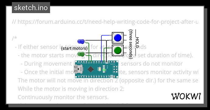

You ignored post #4, showing how to do step #1 (continuously monitor a sensor). Thanks.
Your list of actions is sloppy. You have gaps and make assumptions to things happening.
Here is step #2. (if "either" sensor is triggered for three seconds, motor moves). In this, the sensors are pushbuttons with active LOW (but your motion sensors are active HIGH). Sensor activity for longer than three seconds calls a function (in this case, to light and LED... but can be used to move a motor):
```arduino
byte sensorArray[] = {2, 3}; // two sensors
byte ledArray[] = {7, 8}; // two LEDs
unsigned long timeoutArray[] = {3000, 3000}; // two durations
unsigned long sensorTimer[2];
  for (byte pin = 0; pin < 2; pin++) {
    pinMode(ledArray[pin], OUTPUT); // LEDs for the buttons
    pinMode(sensorArray[pin], INPUT_PULLUP); // sensor pin >> N.O. button pins >> ground
  for (byte pin = 0; pin < 2; pin++) { // reading both input pins
    if (!digitalRead(sensorArray[pin])) { // if button is held
      if (millis() - sensorTimer[pin] > timeoutArray[pin]) { // and timeout is reached
        movement(pin); // move the motor using [pin]
    } else { // button was released
      digitalWrite(ledArray[pin], LOW); // LED off
      sensorTimer[pin] = millis(); // reset timer
void movement(byte pin) { // use this function for motor movement (open AND close)
  digitalWrite(ledArray[pin], HIGH); // LED on
Hardware file for [wokwi.com](http://wokwi.com):
> **diagram.json**

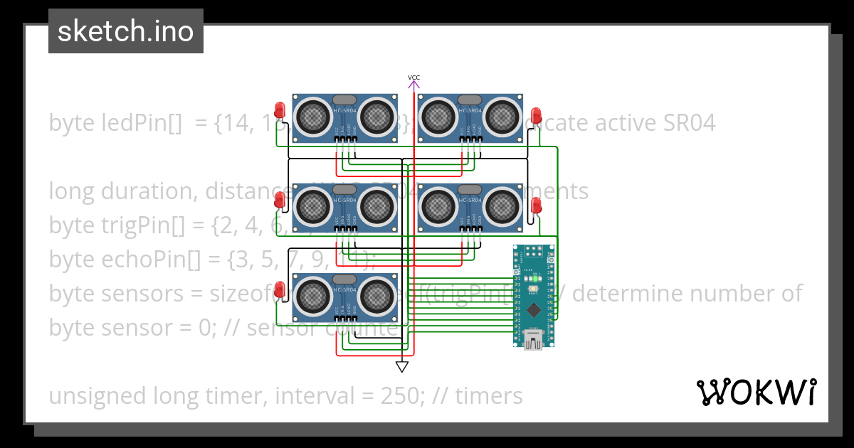

> [@GoForSmoke](#):
> 3cm
2cm - 400cm
Using multiple SR04 (two inside, two outside?)...
> **[SR04x5 - Wokwi ESP32, STM32, Arduino Simulator](https://wokwi.com/projects/399551802093377537)**
> Run IoT and embedded projects in your browser: ESP32, STM32, Arduino, Pi Pico, and more. No installation required!
Files from WOKWI SR04x4:
> **sketch.ino**
> ```arduino
> byte ledPin[] = {16, 17, 14, 15}; // LEDs to indicate SR04
> long duration, distance; // HC-SR04 measurements
> byte trigPin[] = {2, 4, 6, 8};
> byte echoPin[] = {3, 5, 7, 9};
> byte counter = 0; // sensor counter
> unsigned long timer, interval = 500; // timers
> void setup() {
> Serial.begin (115200);
> for (int i = 0; i < 4; i++) {
> pinMode(trigPin[i], OUTPUT);
> pinMode(echoPin[i], INPUT);
> pinMode(ledPin[i], OUTPUT);
> void loop() {
> if (millis() - timer > interval) { // program is running longer than "interval"
> timer = millis(); // store this time
> if (counter > 3) {
> counter = 0; // check counter for overflow
> Serial.println(); // format the Serial Monitor output
> myPing(counter); // call the myPing() function
> counter++; // increment function counter
> void myPing(int SR04) {
> // print/LED
> digitalWrite(ledPin[SR04], HIGH);
> Serial.print("D");
> Serial.print(SR04);
> Serial.print(": ");
> // ping
> digitalWrite(trigPin[SR04], LOW);
> delayMicroseconds(2);
> digitalWrite(trigPin[SR04], HIGH);
> delayMicroseconds(10);
> Serial.print((pulseIn(echoPin[SR04], HIGH) / 2) / 29.1 );
> // print/LED
> Serial.print(" ");
> digitalWrite(ledPin[SR04], LOW);
> **diagram.json**
> ```arduino
> "version": 1,
> "author": "Anonymous maker",
> "editor": "wokwi",
> "parts": [
> "type": "wokwi-arduino-nano",
> "id": "nano",
> "top": -12.4,
> "left": 164.5,
> "rotate": 270,
> "attrs": {}
> { "type": "wokwi-hc-sr04", "id": "ultrasonic1", "top": -161.7, "left": 63.1, "attrs": {} },
> "id": "ultrasonic2",
> "top": -161.7,
> "left": -138.5,
> "attrs": { "distance": "312" }
> "id": "ultrasonic3",
> "top": -315.3,
> "left": -138.5,
> "attrs": { "distance": "100" }
> "id": "ultrasonic4",
> "top": -315.3,
> "left": 63.1,
> "attrs": { "distance": "227" }
> { "type": "wokwi-vcc", "id": "vcc1", "top": -335.24, "left": 48, "attrs": {} },
> { "type": "wokwi-gnd", "id": "gnd1", "top": 57.6, "left": 28.2, "attrs": {} },
> "type": "wokwi-led",
> "id": "led1",
> "top": -157.2,
> "left": -178.2,
> "attrs": { "color": "red", "flip": "1" }
> "id": "led2",
> "top": -301.2,
> "left": -178.2,
> "id": "led3",
> "top": -147.6,
> "left": 234.2,
> "attrs": { "color": "red" }
> "id": "led4",
> "top": -291.6,
> "left": 234.2,
> "connections": [
> ["nano:4", "ultrasonic4:TRIG", "green", ["h-172.8", "v-211.2", "h96.4"] ],
> ["nano:5", "ultrasonic4:ECHO", "green", ["h-172.8", "v-211.2", "h106.4"] ],
> ["nano:2", "ultrasonic3:TRIG", "green", ["h-172.8", "v-192", "h-105.2"] ],
> ["nano:3", "ultrasonic3:ECHO", "green", ["h-172.8", "v-192", "h-95.2"] ],
> ["nano:6", "ultrasonic2:TRIG", "green", ["h-172.8", "v-76.8", "h-105.6"] ],
> ["nano:7", "ultrasonic2:ECHO", "green", ["h-172.8", "v-76.8", "h-96"] ],
> ["nano:8", "ultrasonic1:TRIG", "green", ["h-172.8", "v-96", "h86.4"] ],
> ["nano:9", "ultrasonic1:ECHO", "green", ["h-172.8", "v-96", "h96"] ],
> ["vcc1:VCC", "ultrasonic3:VCC", "red", ["v124.8", "h-124.8"] ],
> ["vcc1:VCC", "ultrasonic2:VCC", "red", ["v278.4", "h-48"] ],
> ["vcc1:VCC", "ultrasonic1:VCC", "red", ["v278.4", "h124.8"] ],
> ["gnd1:GND", "ultrasonic2:GND", "black", ["v-115.2", "h-75.6"] ],
> ["gnd1:GND", "ultrasonic1:GND", "black", ["v-115.2", "h126"] ],
> ["gnd1:GND", "ultrasonic3:GND", "black", ["v-268.8", "h-75.6"] ],
> ["gnd1:GND", "ultrasonic4:GND", "black", ["v-268.8", "h126"] ],
> ["nano:A2", "led2:A", "green", ["h9.6", "v-211.2", "h-442"] ],
> ["nano:A3", "led4:A", "green", ["h9.6", "v-201.6", "h-28.8"] ],
> ["gnd1:GND", "led4:C", "black", ["v-268.8", "h192"] ],
> ["gnd1:GND", "led2:C", "black", ["v-268.8", "h-182.4"] ],
> ["nano:A1", "led3:A", "green", ["h9.6", "v-124.8", "h-38.4"] ],
> ["nano:A0", "led1:A", "green", ["h9.6", "v-134.4", "h-432"] ],
> ["gnd1:GND", "led3:C", "black", ["v-268.8", "h201.6", "v124.8", "h9.6"] ],
> ["gnd1:GND", "led1:C", "black", ["v-268.8", "h-182.4", "v105.6"] ]
> "dependencies": {}
Three-seconds sensor (button) activation of motor (LED) from previous post.
> **[threeSeconds - Wokwi ESP32, STM32, Arduino Simulator](https://wokwi.com/projects/402331679719714817)**
Files for WOKWI threeSeconds...
> **sketch.ino**
> ```arduino
> void setup() {
> Serial.begin(115200);
> void loop() {
> **diagram.json**
> ```arduino
> "version": 1,
> "editor": "wokwi",
> "parts": [
> { "type": "wokwi-arduino-nano", "id": "nano", "top": 0, "left": 0, "attrs": {} },
> "type": "wokwi-pushbutton",
> "id": "btn1",
> "top": -61,
> "left": 144,
> "attrs": { "color": "green" }
> "id": "btn2",
> "top": -109,
> "left": 144,
> "attrs": { "color": "blue" }
> "id": "led1",
> "top": -106.8,
> "left": 11,
> "rotate": 270,
> "attrs": { "color": "blue", "flip": "1" }
> "id": "led2",
> "top": -58.8,
> "left": 11,
> "rotate": 270,
> "attrs": { "color": "green", "flip": "1" }
> "type": "wokwi-text",
> "id": "legendservo1",
> "top": -86.4,
> "left": 182.4,
> "rotate": 90,
> "attrs": { "text": " ____HOLD____ \n(three seconds)" }
> "id": "legendservo2",
> "top": -76.8,
> "left": -48,
> "attrs": { "text": "(start motors)" }
> "connections": [
> ["nano:GND.2", "btn1:2.l", "black", ["v0"] ],
> ["nano:2", "btn1:1.l", "green", ["v0"] ],
> ["nano:GND.2", "btn2:2.l", "black", ["v0"] ],
> ["nano:3", "btn2:1.l", "blue", ["v0"] ],
> ["nano:GND.2", "led1:C", "black", ["v0"] ],
> ["nano:GND.2", "led2:C", "black", ["v0"] ],
> ["nano:8", "led1:A", "green", ["v0"] ],
> ["nano:7", "led2:A", "green", ["v0"] ]
> "dependencies": {}

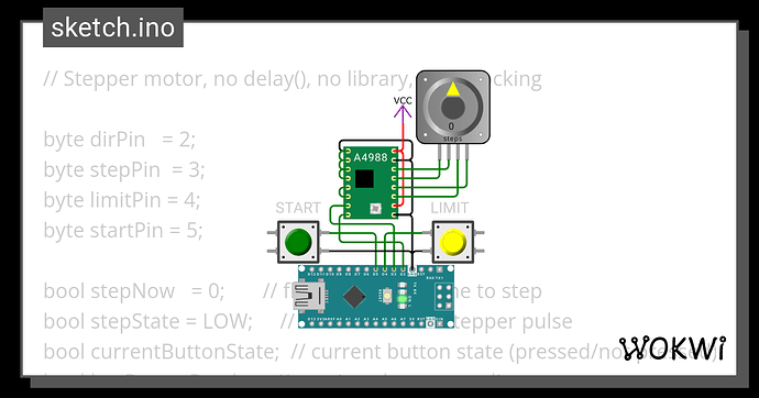

Then make a motor run on millis(), something like this...
> **[stepperNonBlocking - Wokwi ESP32, STM32, Arduino Simulator](https://wokwi.com/projects/366398086217405441)**
Files for WOKWI stepperNonBlocking...
> **sketch.ino**
> ```arduino
> // Stepper motor, no delay(), no library, non-blocking
> byte dirPin = 2;
> byte stepPin = 3;
> byte limitPin = 4;
> byte startPin = 5;
> bool stepNow = 0; // flag to indicate time to step
> bool stepState = LOW; // used to start a stepper pulse
> bool currentButtonState; // current button state (pressed/not pressed)
> bool lastButtonRead; // previous button reading
> unsigned long previousMillis = 0; // store last step
> unsigned long interval = 2; // (milliseconds) half-interval for stepping
> unsigned long debounceTimeout = 50; // debounceTimeout
> unsigned long timer = 0; // measures button press time
> void setup() {
> Serial.begin(9600);
> pinMode(dirPin, OUTPUT);
> pinMode(stepPin, OUTPUT);
> pinMode(limitPin, INPUT_PULLUP);
> pinMode(startPin, INPUT_PULLUP);
> digitalWrite(dirPin, HIGH); // 1 = CW
> welcome();
> while (digitalRead(startPin)); // wait for START button press
> Serial.print(" ***PRESS LIMIT***");
> void loop() {
> checkElapsedTime();
> stepMotor();
> readSwitch();
> void readSwitch() {
> bool currentButtonRead = digitalRead(limitPin); // read button pin
> if (currentButtonRead != lastButtonRead) { // if button pin reading changes...
> timer = millis(); // ...start a timer
> lastButtonRead = currentButtonRead; // ... and store current state
> if ((millis() - timer) > debounceTimeout) { // if button read change was longer than debounceTimeout
> if (currentButtonState == HIGH && lastButtonRead == LOW) { // ... and State NOT pressed while Button PRESSED
> // change stepper direction and light the LED
> digitalWrite(dirPin, !digitalRead(dirPin));
> digitalWrite(LED_BUILTIN, !digitalRead(LED_BUILTIN));
> if (digitalRead(dirPin))
> Serial.print(" CW");
> else
> Serial.print(" CCW");
> currentButtonState = currentButtonRead; // change the state
> void checkElapsedTime() { // for the stepper motor
> unsigned long currentMillis = millis(); // store the time
> if (currentMillis - previousMillis >= interval) { // compare elapsed time to interval
> previousMillis = currentMillis; // store last step time
> stepNow = 1; // flag to indicate it is time to step the motor
> void stepMotor() {
> if (stepNow) {
> stepNow = 0; // clear step flag
> // two methods to step the stepper...
> squarewave(); // HIGH for interval, LOW for interval
> // singlepulse(); // HIGH/LOW pulse then wait for next interval
> void squarewave() { // toggle the state
> stepState = !stepState;
> delay(10); // let the motor catch arrive at the next step
> digitalWrite(stepPin, stepState); // step the motor
> void singlepulse() { // minimum requirement to step a stepper
> digitalWrite(stepPin, HIGH);
> delay(10); // let the motor arrive at the next step
> digitalWrite(stepPin, LOW);
> void welcome() {
> Serial.println("Step and change direction using event timing.");
> Serial.println("- non-blocking\n- no library\n- square wave or single pulse\n **PRESS START**");
> **diagram.json**
> ```arduino
> "version": 1,
> "editor": "wokwi",
> "parts": [
> { "type": "wokwi-arduino-nano", "id": "nano", "top": -24, "left": -38.9, "attrs": {} },
> "type": "wokwi-stepper-motor",
> "id": "stepper1",
> "top": -230.41,
> "left": 89.82,
> "attrs": { "size": "8", "arrow": "yellow" }
> { "type": "wokwi-a4988", "id": "drv1", "top": -148.8, "left": 14.4, "attrs": {} },
> { "type": "wokwi-vcc", "id": "vcc1", "top": -200.84, "left": 67.2, "attrs": {} },
> "id": "btn1",
> "top": -70.6,
> "left": 96,
> "attrs": { "color": "yellow" }
> "top": -96,
> "left": 105.6,
> "attrs": { "text": "LIMIT" }
> "top": -96,
> "left": -57.6,
> "attrs": { "text": "START" }
> "id": "btn3",
> "top": -70.6,
> "left": -67.2,
> "connections": [
> ["drv1:GND.2", "drv1:GND.1", "black", ["h19.35", "v57.6"] ],
> ["nano:GND.2", "drv1:GND.1", "black", ["v0"] ],
> ["drv1:STEP", "nano:3", "green", ["h-19.2", "v19.2", "h67.2"] ],
> ["drv1:RESET", "drv1:SLEEP", "green", ["h-9.6", "v9.6"] ],
> ["drv1:GND.2", "drv1:ENABLE", "black", ["h19.35", "v-20.85", "h-76.8", "v11.33"] ],
> ["nano:2", "drv1:DIR", "green", ["v-28.8", "h-67.2", "v-28.8"] ],
> ["vcc1:VCC", "drv1:VMOT", "red", ["v0"] ],
> ["drv1:VMOT", "drv1:VDD", "red", ["h9.75", "v57.6"] ],
> ["drv1:2B", "stepper1:A+", "green", ["h0"] ],
> ["drv1:2A", "stepper1:A-", "green", ["h0"] ],
> ["drv1:1A", "stepper1:B-", "green", ["h0"] ],
> ["drv1:1B", "stepper1:B+", "green", ["h0"] ],
> ["drv1:ENABLE", "drv1:MS1", "green", ["h-9.6", "v9.6"] ],
> ["drv1:MS1", "drv1:MS2", "green", ["h-9.6", "v9.6"] ],
> ["drv1:MS2", "drv1:MS3", "green", ["h-9.6", "v9.6"] ],
> ["nano:4", "btn1:1.l", "green", ["v0"] ],
> ["nano:5", "btn3:1.r", "green", ["v0"] ],
> ["nano:GND.2", "btn3:2.r", "black", ["v0"] ]

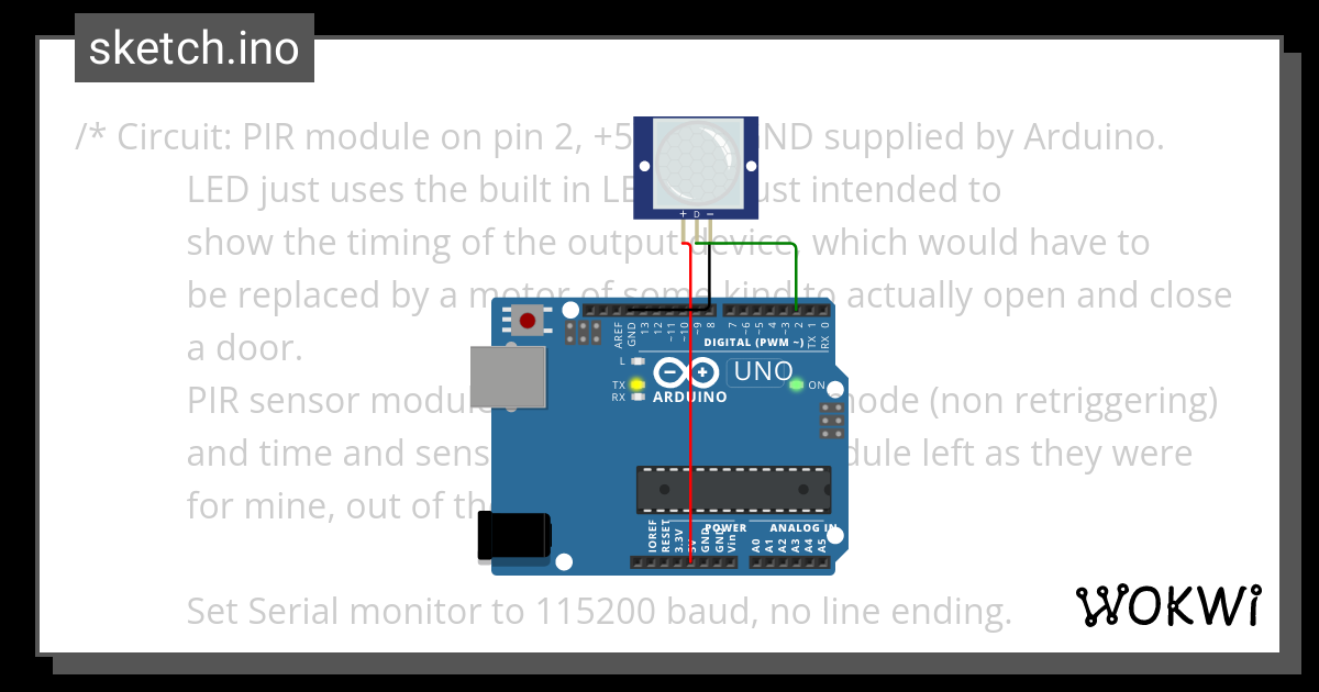

> [@captkirk151](#):
> Once I get the code working
Here's a PIR version, a demo, of the sort of thing that will get the job done. Should be pretty self explanatory. I may revise it to add a second sensor or I may leave kitty outside to beg (meow) his privileged butt back inside.
Ooh, maybe a sound sensor...
```arduino
/* Circuit: PIR module on pin 2, +5V and GND supplied by Arduino.
            LED just uses the built in LED. It's just intended to
            show the timing of the output device, which would have to
            be replaced by a motor of some kind to actually open and close
            a door.
            PIR sensor module set to LOW jumper mode (non retriggering)
            and time and sensitivity pots on the module left as they were
            for mine, out of the box.
            Set Serial monitor to 115200 baud, no line ending.
            More info on PIR sensor courtesy of Adafruit Industries:
            https://learn.adafruit.com/pir-passive-infrared-proximity-motion-sensor/testing-a-pir
 Timing/sensor explanation:
      This is intended for a motivated cat. That is, kitty is gonna have
      to work a little so the door doesn't just open if the cat is merely
      detected once. What if Mr. Whiskers decides to sleep in front of
      the kitty door? You want him to catch a cold from an open door?
      So this presumes Mr. Whiskers perhaps paws at something of circles
      or paces or looks back at his pet human indicating a desire to cross
      the threshold of the door. My two cats certainly do.
      Then, once the cat has been moving for three seconds, he is considered
      present and wanting the door to open. It will open (led will light up
      for this demo).
      If Mr Kitty decides to waffle about before crossing the threshold, he
      will continue to be detected and the door will stay open as long as he's
      purposefully wasting his day away as cats are known to do.
      It will stay open for another five seconds once he has passed through
      the door.
 by Hallowed31, July 03, 2024.
 Countdown timer technique courtesy of cattledog from the Arduino Forum.
int ledPin = LED_BUILTIN;
int pirPin = 2;
int ledState;
int lastLedState;
int pirState;
int lastPirState;
int eventCounter = 0;
unsigned long stopwatchRuntime = 0;
unsigned long lastStopwatchCheck = 0; // keep track of time that no detection changed to detction
unsigned long stopwatchTimer = 0; // keep track of time at every new detection event
unsigned long holdDoorOpenTimer = 0;
const long interval = 1000; // how often to reprint door open timer on Serial monitor
int timer = 5;
  pinMode(ledPin, OUTPUT);
  pinMode(pirPin, INPUT);
  Serial.println("pirCatDoorTimerDemo");
  Serial.println();
  pirState = 0; // set initial states
  lastPirState = 0;
  ledState = 0;
  lastLedState = 0;
  stopwatchRuntime = millis(); // start free running timer that never actually stops
  pirState = digitalRead(pirPin);
  switch (pirState) {
    case 0:
      /* cat got door open by moving, time for device to obey cat */
      theCatsOutOftheBag();
    case 1:
      /* cat moving to open door, ie not just sleeping there */
      ledState = pirState;
      theCatsInTheBag();
void theCatsInTheBag() {
  stopwatchTimer = stopwatchRuntime - lastStopwatchCheck;
  if (lastPirState == 0) {
    lastPirState = 1;
    eventCounter += 1;
  catDetectING(); // print Serial debugging data for events and timer
  if (stopwatchTimer > 3000) { // if cat keeps moving over timeframe of three seconds...
    digitalWrite(ledPin, ledState); // do the thing (turn led on in this test)
    lastLedState = ledState; // and set state to act upon so as soon as cat through door, it holds
void theCatsOutOftheBag() {
  lastPirState = pirState;
  lastStopwatchCheck = stopwatchRuntime;
  if (lastLedState == 1) {
    if (stopwatchRuntime - holdDoorOpenTimer >= interval) {
      holdDoorOpenTimer = stopwatchRuntime;
      catDetectED(); // print Serial debugging data for events, timer and door countdown
      timer--;//decrease timer count
      if (timer == -1)// less than 0
        doorClosingMessage();
        timer = 5; // reset timer variable for next door opening event
        lastLedState = lastPirState;
    digitalWrite(ledPin, lastLedState);
  else {
    lastLedState = 0;
void catDetectED() {
  Serial.print("Event Counter: ");
  Serial.print(eventCounter);
  Serial.print("\tTime since detection: ");
  Serial.print(stopwatchTimer);
  Serial.print("\tDoor open timer: ");
  Serial.println(timer);
void catDetectING() {
  Serial.println(stopwatchTimer);
void doorClosingMessage() {
  Serial.println();
  Serial.println("Closing Door - watch your tail!");
  Serial.println();
Note, this is intended to sort of show how i go about doing these projects. One simple sensor first (PIR have a few good options built in that bypasses the need to actually code for certain things - in fact it bypasses the need for an Arduino altogether if you're good with transistors and relays), and also the simplest of outputs - the Arduino built in LED, to have a super reliable output circuit that rules out things like motor drivers or shoddy wiring when you're just trying to get the code logic right.
Oh, one more thing: This code works as I intended it to. If you decide to try it, great. If you find parts useful and adapt them to your project, great, but I recommend you _do not modify_ what I posted. It's code that works, so make a copy of it, rename it something else, don't forget to change the name here `Serial.println("pirCatDoorTimerDemo");` in `void setup()` to something else, and make changes to your copy.
That way it's easy to just roll back to what already worked if need be.
It's just a good habit in this hobby.
Oh, and since it's in fashion (although my irl version isn't the default PIR setup but this still works in Wokwi), here's a Wokwi.
> **[Motion Sensor Demo For Cat Door - Wokwi ESP32, STM32, Arduino Simulator](https://wokwi.com/projects/402416156752535553)**
