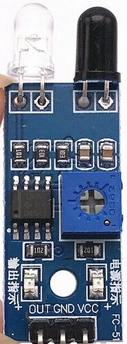

Same thoughts I had using the unit below.
Could quite easily house everything close by the cap in a mechanically substantial housing with a tube to direct the IR beam more to the rim of the cap for example.
Could also have the IR beams operating through a clear plastic cover for weatherproofing.
5 x IR Infrared Obstacle Avoidance Sensor Module for Arduino Smart Car Robot for sale online | eBay
I'll have to read up on that module after some shut eye. That might very well be the ticket. I'll have to think on how to get a good reflective surface as those caps are mounted at an angle. But if I go that route, I'll come up with something.
