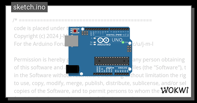

this won't match exactly your command language, but I wrote a demo class that helps with parsing multiple commands received on a Stream (like Serial). May be that will inspire you for your code or you can just adopt the class and use it if you can tailor your command language.
You can see the code in the simulator here
the command language recognises 4 types of commands
  • just a keyword, like ENGINE
  • a keyword, followed by a colon or equal sign (: or =) and any word, like ENGINE:ON or ENGINE=ON
  • a keyword, followed by a sharp sign (#) and any word, like ENGINE#12
  • a keyword, followed by a sharp sign (#) and any word, followed by a colon or equal sign and any word, like ENGINE#23:ON or ENGINE#23=128
of course when I say any word it must be something not containing one of the separators
The command can be terminated by a newline, semicolon, or tab.
so basically the commands look like this
KEYWORD
KEYWORD[=:]VALUE
KEYWORD#QUALIFIER
KEYWORD#QUALIFIER [=:]VALUE
End command by newline, semicolon, or tab.
where KEYWORD, VALUE and QUALIFIER can't hold any character from =:;\t\n
The way you use the class is that you define all the commands and the way they look like in an array of type CommandDescriptor where you set an ID of the command, the KEYWORD, and then the type (BARE_COMMAND will be just the keyword, VALUE if you have a value after the keyword (with = or :), QUALIFIER if you just have the qualifier after the keyword (with #), or QUALIFIER_VALUE if you have both.
const CommandDescriptor orders[] = {
  {0, "ENGINE", BARE_COMMAND},      // just a keyword 'ENGINE'
  {1, "ENGINE", VALUE},             // 'ENGINE:ON'
  {2, "ENGINE", QUALIFIER},         // 'ENGINE#12'
  {3, "ENGINE", QUALIFIER_VALUE},   // 'ENGINE#23:ON' or 'ENGINE#23=128'
const size_t numberOfOrders = sizeof orders / sizeof * orders;
Then you instantiate an Analyzer object that is templated with the max count of characters you accept in a command line, for example if I want a buffer of 100 characters I would write , you pass the orders and how many you have and the Stream to listen to.
Analyzer<100> analyzer(orders, numberOfOrders, Serial);// 100 characters is the maximum length of a received command
This works by polling, so the loop can't block, and you call
  CommandDetail * theCommand = analyzer.receivedCommand();
which will poll the Stream and wait for a full command line (terminated by a new line). When a command is recognised, theCommand will be a pointer to a CommandDetail structure with the information about the recognized data.
You can see in the example how I used that.
try typing in the Serial Monitor things like:
ENGINE
ENGINE:ON
ENGINE#2:STOP
ENGINE#3:FULL SPEED
ENGINE#4=128
or a few orders in one go (remember we set the max at 100 chars)
ENGINE;ENGINE:ON;ENGINE#2:STOP;ENGINE#3:FULL SPEED;ENGINE#4=128
if you try that last one, you'll see in the monitor
Recognized Command:
	Command: "ENGINE"	(ID: 0)
Recognized Command:
	Command: "ENGINE"	(ID: 1)
	Value: "ON"
Recognized Command:
	Command: "ENGINE"	(ID: 3)
	Qualifier: "2"
	Value: "STOP"
Recognized Command:
	Qualifier: "3"
	Value: "FULL SPEED"
Recognized Command:
	Qualifier: "4"
	Value: "128"
