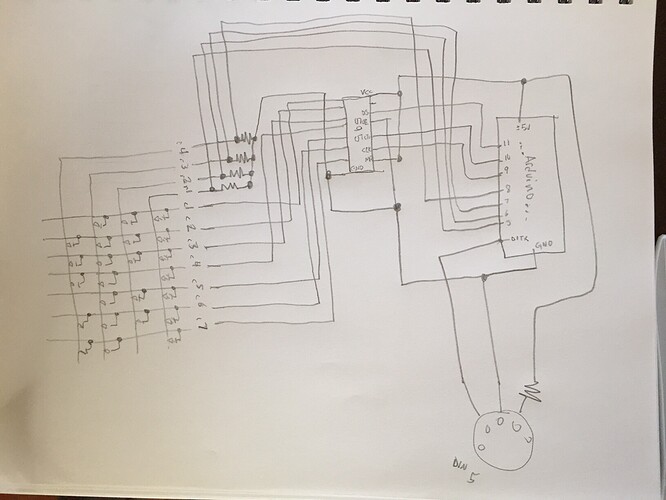

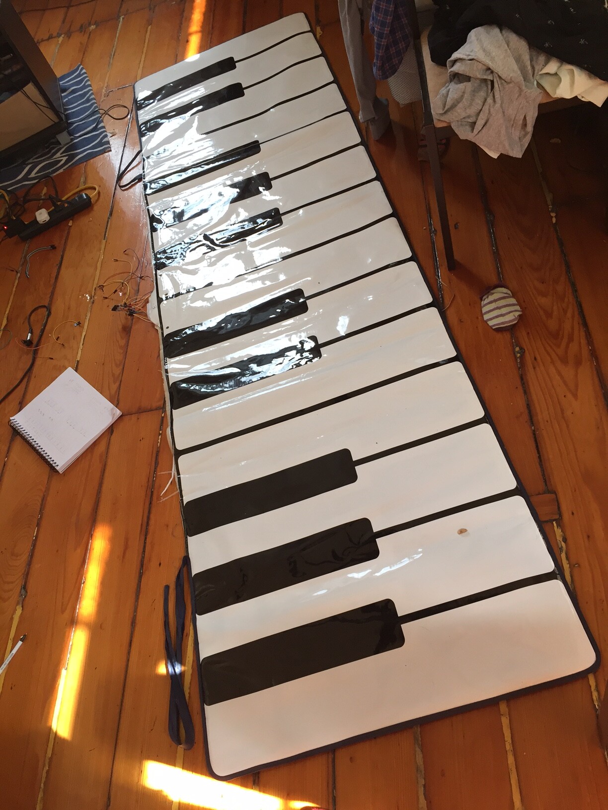

first of all!! thanks for responding!! to answer a previous question.. i am using the pin 13 led on an arduino uno.. just to test my keys..i am using the code from the switch tutorial...

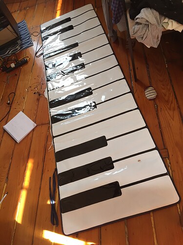

so i am trying to turn this...
into a midi controller..

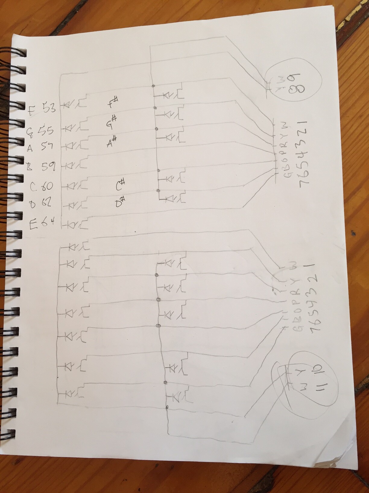

the pads are triggered through two piece of electric painted plastic that connect through holes in foam when you step on a 'key'
the pads connections go like this.

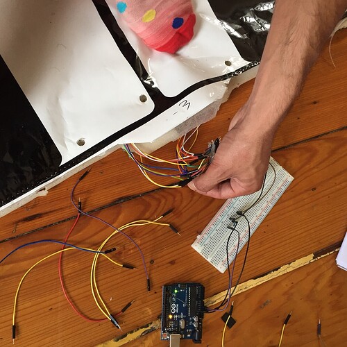

the led fires up only when i step on the 'middle e 'key when i have only the middle e key set up as the switch. even then, the further down i press on the key, the fainter the light becomes. when i move it to any other key it doesnt work.
i thought i was having trouble with the code and using a shift register. but now seeing that the keys are (im guesing) not juiced enough. i need to tackle this first.
what did i miss?
You're trying to push enough current through that kind of connection and get enough out to force an INPUT pin HIGH....
It would be good to measure the resistance through one of those switches.
You might read those switches easier if you set your sense/input pins to INPUT_PULLUP because pins set to that mode only have to be drained of their weak supply current, not raised from LOW to HIGH.
You would need to ditch the shift register and use pins instead that you switch between INPUT (when you don't read an input, the connect is neutral) and OUTPUT (both LOW) which a 595 shift register won't do.
The thing is that I don't know if your switches can take the weak pullup current down if their resistance through the conductive paint is too high.
Can I suggest you forget for the moment about the Midi programming.
Just write code for reading your keypad and nothing else.
Get it working then do the Midi bit.
As @GoForSmoke has suggested, you need to measure the Pad ON and OFF resistance with a DMM.
Also a good circuit diagram would help, NOT A FRITZY picture, but a diagram showing ALL your wiring and label pins, either CAD or a picture of a hand drawn circuit in jpg, png?
Tom... :slight_smile:

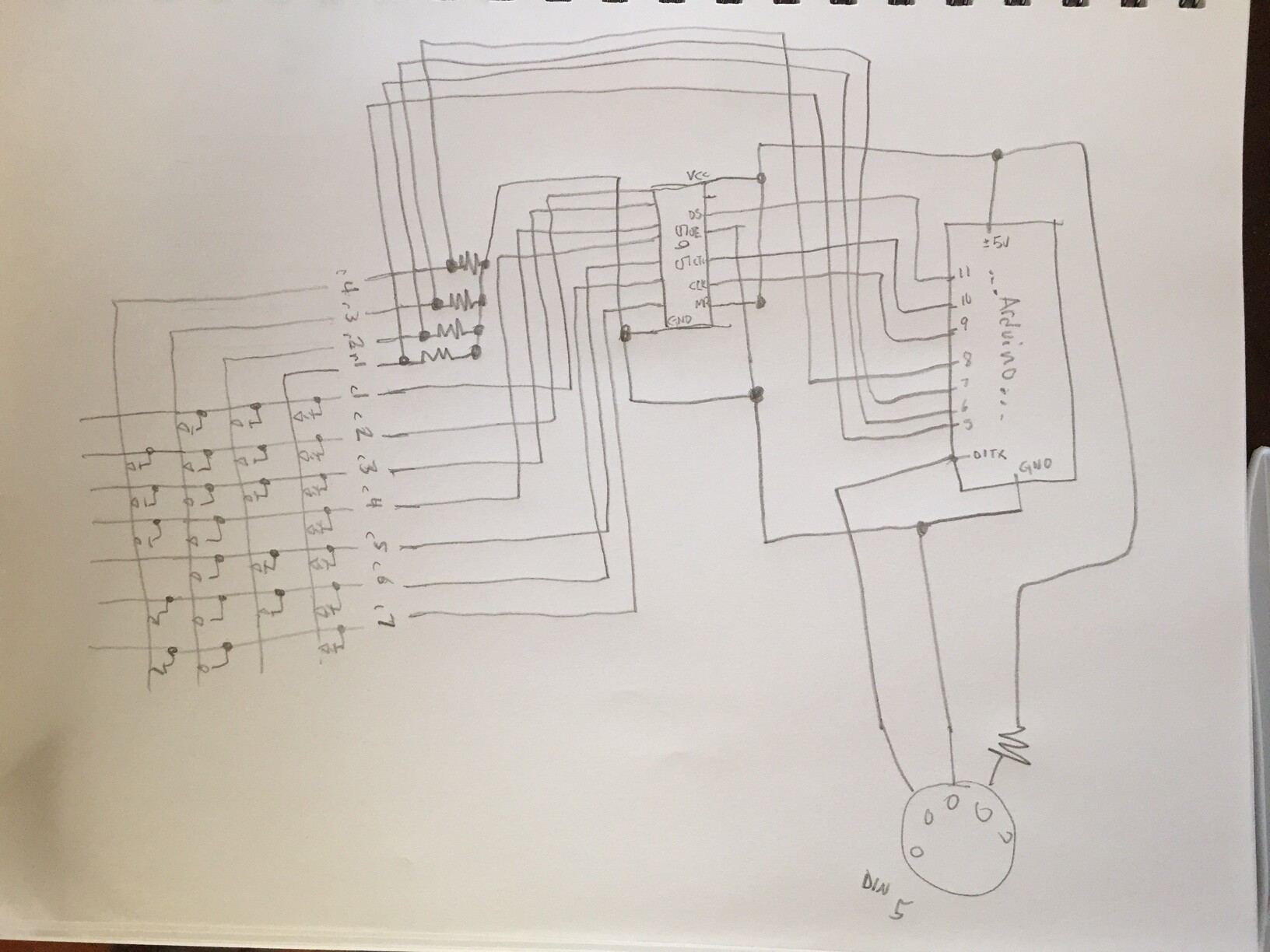

here's that diagram!

Now about your diagram:
EdWino:
What's this "595" component? The other markings are unreadable. I guess it's some form of input?
Is that "DIN5" also your power supply? If not where is your power supply?
What is that bottom left marker in the "Arduino" box? Can't read it.
What is the value of those four resistors?
wvmarle:
  1. its a 74HC595 shift register
  2. din5 is the female midi output jack, power supply is currently just the arduino hooked in through its usb port.
  3. the is the pin1 tx output for the midi
  4. the four resistors re 10k, there is also one 220 going into the power jack to the din5
