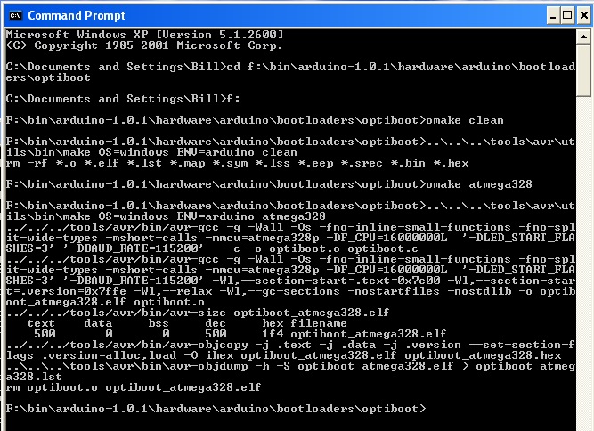

I don’t understand this part. Recent optiboot sources are set up to compile using the same tools and same environment as Arduino itself. Just connect to the source directory and use the “omake” batch script.
thats what i thought too but the only tutorial i saw referred to something called "mercurial" or something and im literally on the edge of overflow on my ssd so made no attempt to download. some of these modern tools are horrifically bloated so my main toolset is atmel assembler and an older arduino shell. im not fully up to speed on raw winavr procedures. im using an older version (arduino 0022 in a folder named 0arduino-0018) and newer ones dont fit. with raw winavr i get bogged down with missing files and directories which is not a problem with assembler and current arduino shell which are working ok for me right now. i hestate to change anything because it all falls down when i do.
there is (probably older) version of optiboot.c and makefile in "f:\0arduino-0018\hardware\arduino\bootloaders". clicking on makeall or makefile causes xp to ask for a program. any suggestions how to fix?
Here is my optiboot folder. I have made a batch file which redirects calls to the missing files to the correct folder so windows can find them.

this is great. i unzipped into the optiboot folder then clicked on the tiny84 batch which created elf/hex/lst. i cant believe how easy that was. nothing like this worked before. thanks again.
now to do this for mega8 8mhz i add a modified mega8 entry in makefile and create another batch file? i know how to do that. is there anything else needed?
Yeah, sorry that version of the folder is from my laptop, I created the mega8 batch file on my desktop. Either you can make your own, or i can upload the one I made this evening. If you make your own you will have to modify the makefile to add an 8MHz entry.
yes, i did that and it worked. the hex needs testing but i have a good feeling that will work too. thanks for showing me the way. i got a fish AND was taught the black art of fishing. :slight_smile:
