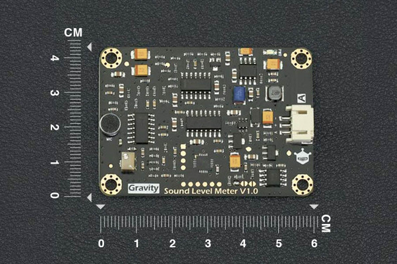

I would recommend this product:
Gravity: Analogue Sound Level Meter.
Sound Level Meter
It has an output that is already calibrated, and is 50dBA/volt.
Just measure the output voltage in volts and multiply by 50 and you have the sound pressure level.
There is a Wiki for it here.
It might not fit in your matchbox though.
