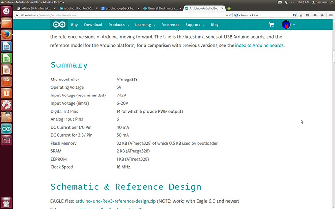

Also, I'm unsure of what voltage to use as my input (to trigger an LED)
This is from aduino's webpage for the Uno
