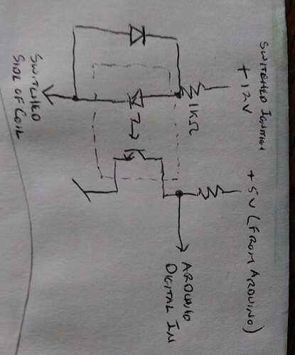

The ignition coil should have switch to ground on the primary side which would seem to be the more straightforward way to go about sensing RPM. Something like +12 V : 1k resistor : optoisolator LED diode : switched side of ignition coil in parallel with a flyback diode should do it.
I think you just explained exactly what I'm trying to do in a similar project. I have a few questions, sorry if they're overly simple
Is the +12V just coming from the battery or something, to pull the pin high when then coil is not grounded?
What are optoisolator and flyback diodes?
Would you mind drawing me a simple schematic? I would really appreciate it!

smiles79:
The +12 would be from the battery. Strictly from a circuit that is switched on when the engine is running, so as not to drain the battery when the vehicle is parked.
An optoisolator is an LED and a phototransistor in a single package. The idea is that the LED and phototransistor are not electrically connected so that voltage spikes, transients, and other such garbage on the automotive electrics side is not directly connected to the Arduino. Transients are generally present on automotive circuits and largely originate from the ignition coil.
A flyback diode is a diode that is normally reversed biased. It is used to protect other circuitry (the optoisolator LED in this instance) from a momentary reverse voltage spikes.
On the back of a literal envelope:
