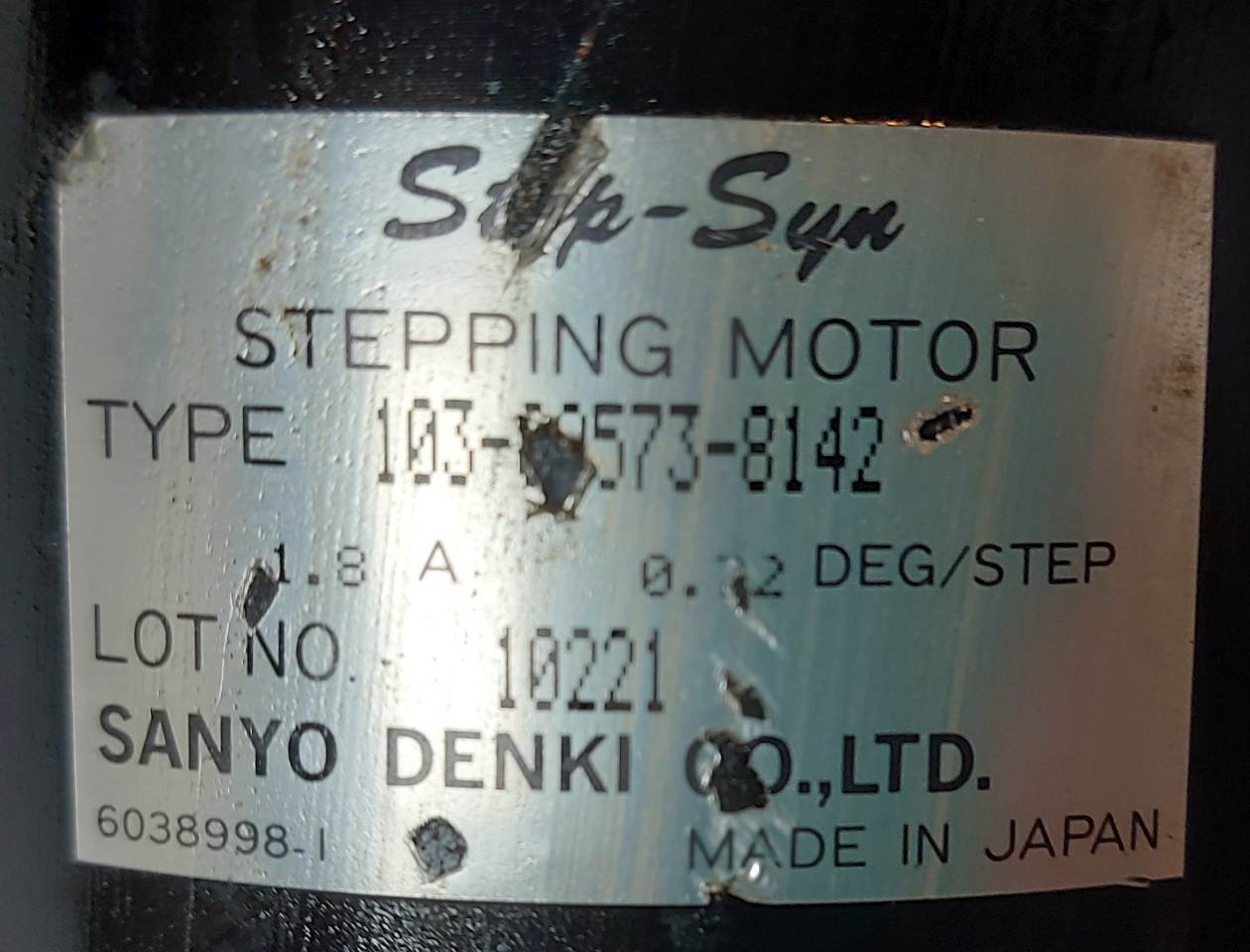

Have a LARGE step-syn stepper motor.
Main label and think the step is .72
It has 5 wires
Rear plate was just a brand name plate so nothing to gain with it but included for reference.
Metered out the connections as follows.
WIRE COLOURS
BLUE, RED, YELLOW, ORANGE, BLACK.
BLUE - YELLOW = 2.7 OHMS
BLUE - RED = 3.9 "
BLUE - ORANGE = 3.9 "
BLUE - BLACK = 2.7 "
YELLOW - RED = 4.0 "
YELLOW - BLACK = 4.0 "
YELLOW - ORANGE = 2.6 "
ORANGE - BLACK = 3.9 "
ORANGE - RED = 2.7 "
RED - BLACK = 2.6 "
Have a spare TB6600 and wondered if I can utilise it ?
If so what would be the correct combination of pairs ?
I think that was either a custom design for someone or it's a 5 wire design with some shorts inside.

Look for a 5 phase stepper motor. For info see: https://www.motioncontroltips.com/what-are-the-performance-benefits-of-5-phase-stepper-motors/
I once had a CNC milling machine with 5-phase stepper motors. I could, perhaps research the name. Was originally for use as a teaching help in schools.
The reason for 5 phases is the smoothness of motion. Avoided the stepped tooling marks while milling metal.
The auction site still has all the info. IT was an Enco F1 CNC machine. Rather old!
This may be of some help;
I Googled;
stop-syn 103-89573-8142
Does the back of the motor come off?
I'd say you have a 5 wire motor with coil resistance of about 3.3 Ohms.
let's say that one coil has BLUE and YELLOW wires, you would have 3.3 Ohms in parallel with 4 * 3.3 = 13.2 Ohms.
1 / ((1 / 3.3) + (1 /13.2)) = 2.64 Ohms.
If you measured from BLUE to RED (6.6 Ohms in parallel with 9.9 Ohms).
1 / ((1 / 6.6) + (1 / 9.9)) = 3.96 Ohms.
Only the name plate came off as I had the same idea thinking that there may be terminals inside.
@JCA34F I think you may be correct alas.
There are simply too many variations of this size and make of stepper to be sure of anything.
Only paid $15 for it so not a great loss if I cannot use it.
Just didn't want to pay out for a 5 wire driver unless I had to as they are so much more expensive.
Set myself up a Sanyo account so will see if they still have any tech details for this.
