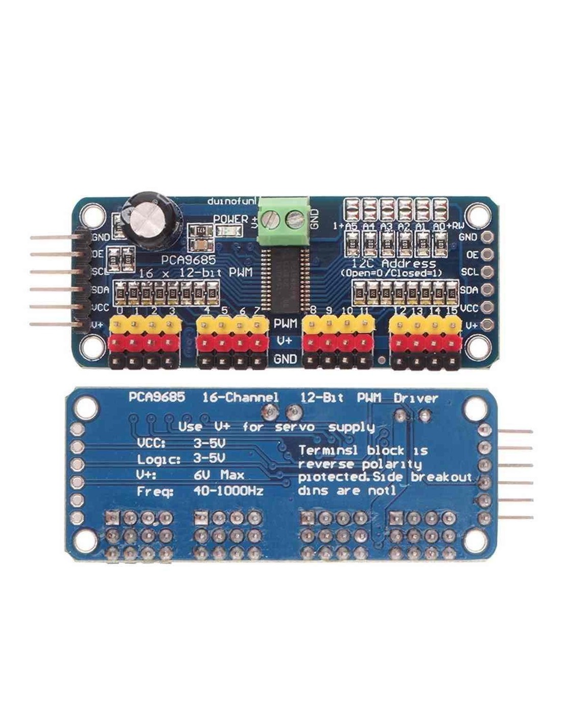

Adafruit 16-Channel 12-bit PWM/Servo Driver - I2C interface - PCA9685

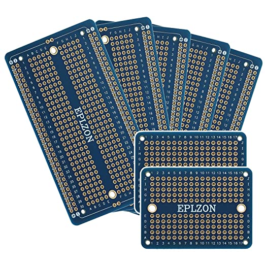

You can buy, or make a servo power distribution PCB. Don't use a logic breadboard, the tracks will burn!
DIY here: https://diyodemag.com/projects/servo_power
https://create.arduino.cc/projecthub/madmark2150/perf-panel-paired-power-plug-piggyback-for-mega-2560-uno-67d604
