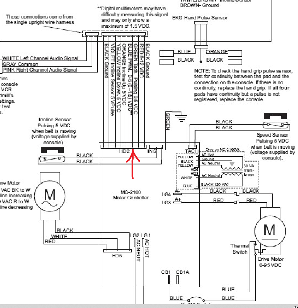

animal
Yes, There is a tach output.
I have marked it with a red arrow:
Thanks , all the time I was looking at that diagram , I never saw that . I was looking at the PWM pins & the incline motor control pins .

Yes, 5v but the real question is... is that output raw or debounced. If it is debounced great you can use it directly to get RPM.
If it isn't you'll need to debounce it before using.

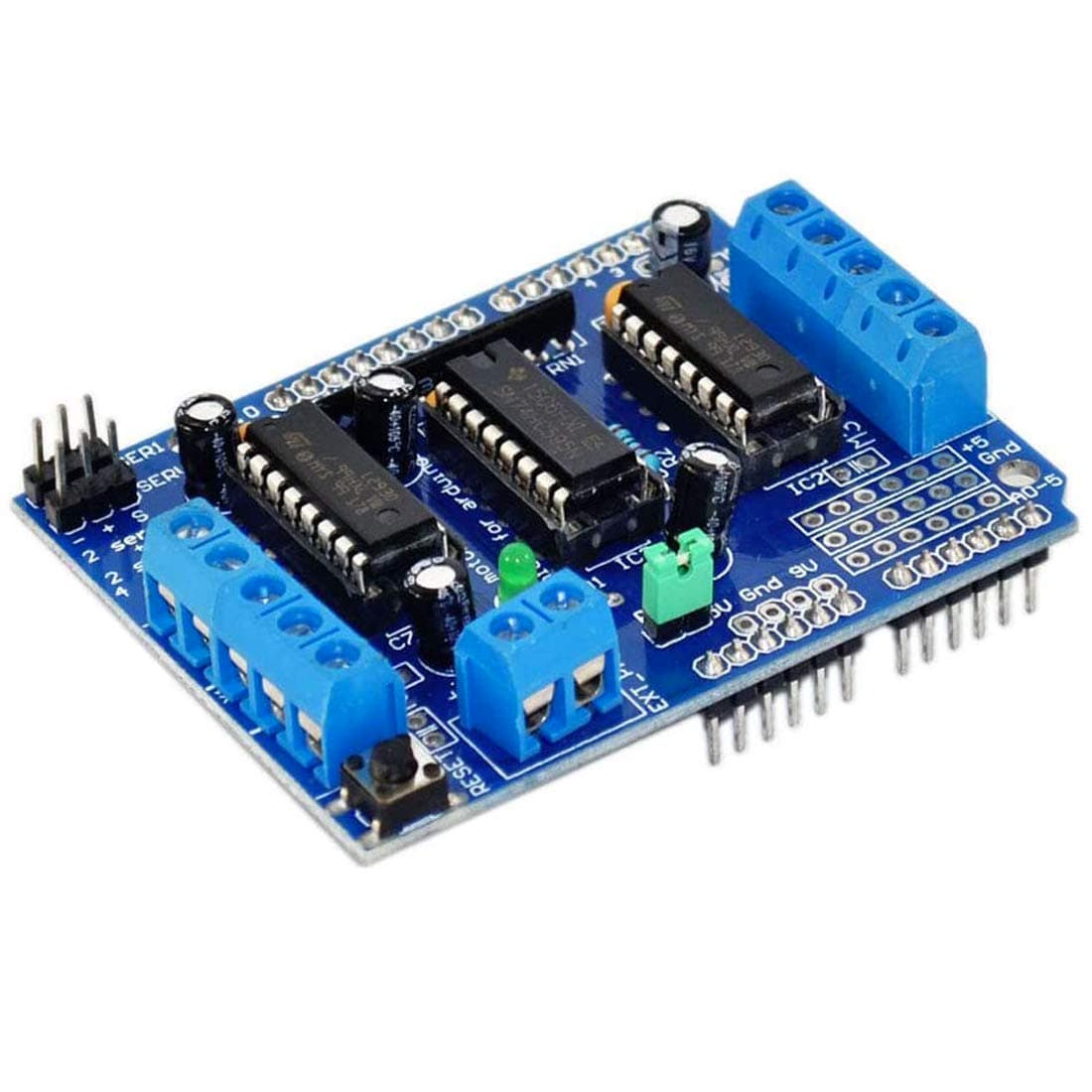

That board looks an awful lot like
or
http://wiki.sunfounder.cc/index.php?title=L293D_Motor_Driver_Shield
Those PWM channels directly connect to Uno Pins 4,6,7,12. If one could contrive to produce 20Hz PWM on one of those pins through hardware timers or soft PWM, it would work.
Unfortunately, 20Hz PWM only works on pin 9.(Timer 1 OC1A)

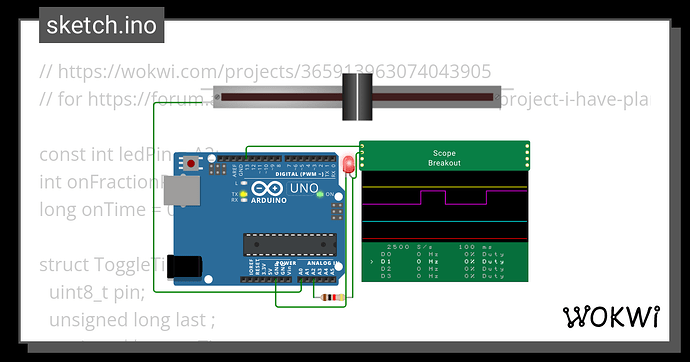

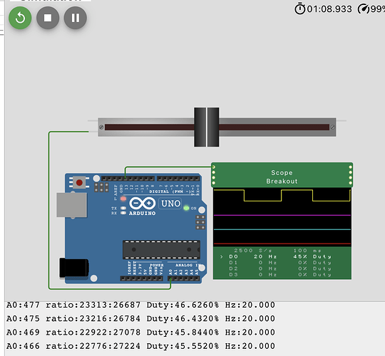

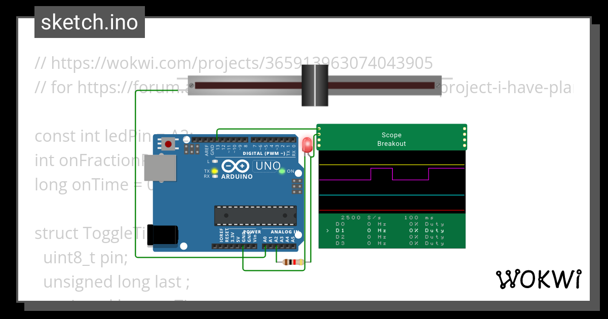

20Hz is 50000us. That's time enough to do a high resolution soft PWM on any pin:
// https://wokwi.com/projects/365913963074043905
// for https://forum.arduino.cc/t/need-to-know-if-the-project-i-have-planed-can-be-done/1121026/37
const int ledPin = 13;
int onFractionPct = 10 ;
long onTime = 0;
struct ToggleTimerPin {
  uint8_t pin;
  unsigned long last ;
  unsigned long onTime ;
  unsigned long offTime;
  uint8_t state ;
} myLed = {13, 0, 10, 100, 0};
unsigned long period = 1000000UL *1000UL/ 20000;
  pinMode(myLed.pin,OUTPUT);
  updateSpeed();
  handleLed(myLed);

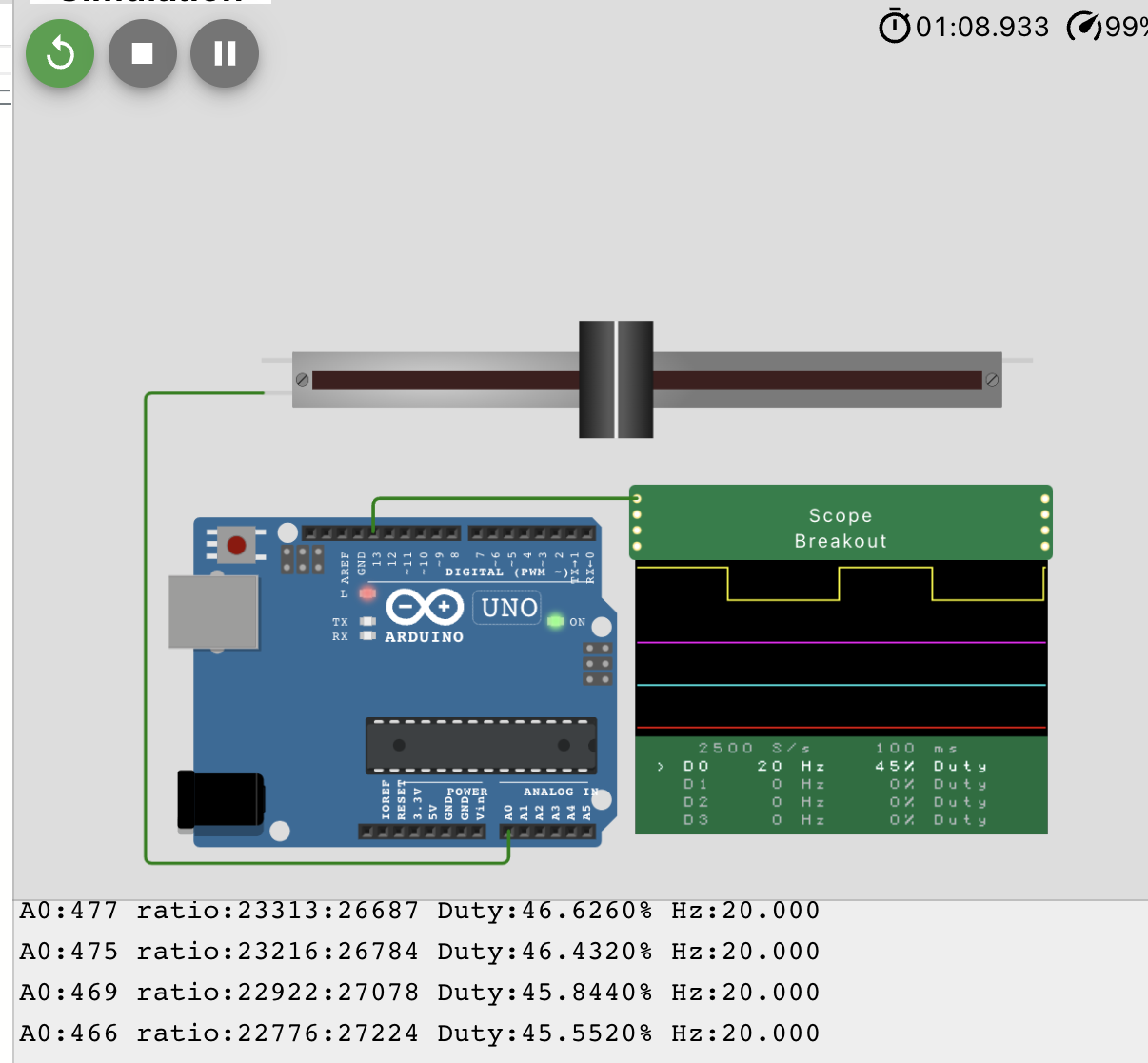

void updateSpeed(void) {
  static int lastADC = -1;
  int myADC = analogRead(A0);
  if (myADC != lastADC) {
    lastADC = myADC;
    myLed.onTime = myADC * period / 1023UL;
    myLed.offTime = period - myLed.onTime;
    Serial.print("A0:");
    Serial.print(myADC);
    Serial.print(" ratio:");
    Serial.print(myLed.onTime);
    Serial.print(':');
    Serial.print(myLed.offTime);
    Serial.print(" Duty:");
    Serial.print(myLed.onTime * 100.0 / period, 4);
    Serial.print("% Hz:");
    Serial.print(1.0e6 / period, 3);
    Serial.print(" \n");

i think its the same board , I got mine from Amazon a few years back

Non-20Hz motors/motor controllers would work on any of them with Hardware PWM, but if you need the 20Hz PWM for the MC-2100, you need software PWM, either through something hand coded like above, or a library that does something similar.
