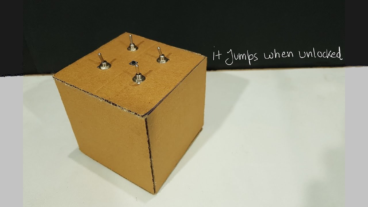

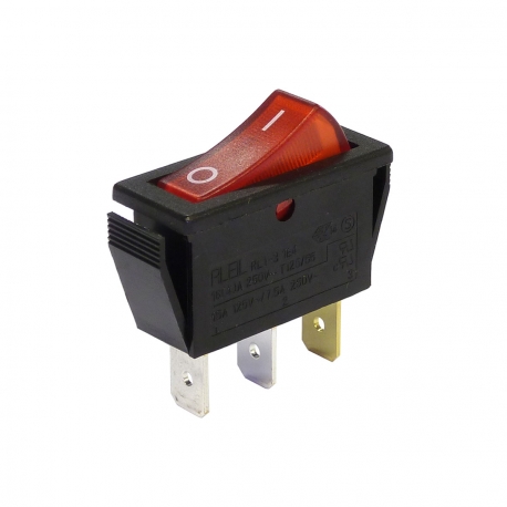

So... I'm building a puzzle box with Switchs Illuminateds with 250V (more than 1, yes), i dont know how to build properly to Mega 2560 Arduino (5V), somebody can help?
(The puzzle box can be plugged into electric current, it doesnt move)

What kind of lights are we talking about? LED's, Neon's,.... Do the already have resistor build in? Do you need to connect these lights to your Mega? Could you give use some more information please, I don't know these kind of puzzles.

These ones:
Is to build a puzzle box kind like this one:
But i cannot light up the "rocker switch" because the 250V conversion, i supose ^^
First of all please step away from 230V - it will kill you if you don't know what you are doing. It even kills people who know what they are doing. Stick to ELV devices - less than 50V AC or 120V DC which even these levels can hurt

I must agree with Mark here, if you only have a limited knowledge of electricity you better don't use 230 volt, but choose to make your project using a lower voltage. In this case you could use a power supply that you plug in and transfers your 230 volts to 12 volts. There are many switches like you showed me available for 12 volt. I watched the video of the puzzle and if you get the combination right the box will open, witch in case you would use 230 volt it would be very easy to touch the switches and get seriously electrocuted.
By using a 230v to 12v power supply you can just plug it in to your box and you are safe.

I agree with the others. You stated you are new to electronics, I'm sure we would all like to see you stay around for a while.
I have a suggestion thought. Perhaps you could:
  • Use the switch you have selected but operate it at 5Vdc (the arduino voltage) and put an LED next to it.
  • Perhaps you could take apart the switch and replace what I expect is a neon bulb with an LED.

I was already doing exactly this now, and the leds and the switcher works fine (John's suggestion):
1.Use the switch you have selected but operate it at 5Vdc (the arduino voltage) and put an LED next to it.
But i thought i could supply the Switchers like Mike said, with a 12V power supply to illuminated them ^^ Exactly how i should do this, just plug in into the Arduino Mega?? Without any requeriment? I dont want to hurt/destroy it :confused:

You can not connect the switches directly to the Mega. First of all you will either need to order new 12 volt switches or rebuild the ones you have to 12 volt, like Mark said. Then you need to get a 12 volt power supply and use the 5 Volt output from your Mega to control either a relay card or use transistors. Your Mega will provide 5 Volt on it's outputs and you can max draw 40mA per output. If you got it working like Mark said, with the LED's then maybe it's better to keep it like that.
Only advisable if you have a spare Mega board. 40ma per output is the "Absolute Maximum Rating", anything beyond this value is guaranteed to cause damage. A much safer number is less than 20 ma and there is a total package rating of 200ma, meaning the total current allowable out of all i/o combined and the processor current is 200 ma maximum.
