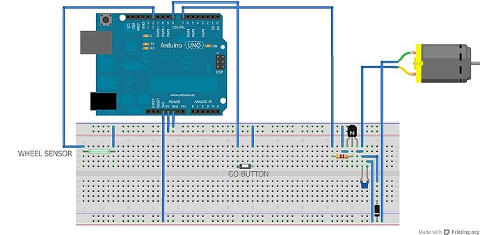

I would be happy to help you. You have mentioned that the students -- at this time -- just need to read and follow instructions. Thus, you don't seem to have the luxury of the hard knocks method. If I am sensing your situation correctly (and I have been wrong in larger towns than this) here are some resources for you.
The car would have a Hall Effect Detector (HED) (such as this one at Hall-Effect Sensor - US1881 (Latching) - COM-09312 - SparkFun Electronics) attached to the body/frame and a magnet placed on one of the wheels. I would suggest a non-drive wheel so that any slippage due to motor torque does not get counted. If a HED is not available then a reed switch that closes to ground to produce a LOW when the magnet is aligned will do. The HED is much cleaner, more sensitive and reliable.
The DC motor would be connected with a 2n2222 npn transistor (or equivalent -- handling about 200mA max) between the motor and ground. If your motor draws more than 200mA, then TO-220 NPN transistor (like the TIP31) will need to be used. Be sure to place a reversed diode (cathode toward +DCV) in parallel with the motor to handle any back-EMF when the motor is stopped. A 1N4001 is a defacto standard, methinks. Run a 4.7k ohm resistor from the Arduino pin to the base of the transistor (if you decide to use a lower beta power transistor, you might want to use a 1k resistor to assure saturation), the emitter goes to ground, and the collector goes to the bottom (negative) side of the motor. I would place a 0.1uFd capacitor in parallel with the motor and diode just to keep noise down.

I think that it works, but don't have the hardware to fully test. If you need a schematic, I could rustle one up. For the transistor driving a DC motor look here Tutorial 5 for Arduino: Motors and Transistors – JeremyBlum.com for a cool tutorial thanks to Jeremy Blum. There's a video and everything!
Let us know if you need more help, and let us know how it turns out. Photos or videos would be cool.

I am attaching a breadboard picture and a crude schematic, which has the motor connected to 3.3V as I believe you are using a 3V pager motor, yes?
You can have the students breadboard the project without the Hall Effect sensor like this:
*Run the wire from D12 to +5V to simulate the wheel being out of alignment.
*Download and run the code. The D13 (READY) should be OFF, indicating that you aren't ready to start.
*Move the D12 wire from +5V to GND, which simulates the magnet aligning. The D13 (READY) LED should come ON to indicate that the wheel is now aligned and we're ready to go.
*Press the GO button. The motor should start running.
*Now move the D12 wire between between GND and +5V ten times.
*After the tenth transition from HIGH to LOW (this number is a constant in the code), the motor should turn OFF.
You can test the setup and get everything working so that, when the Hall Effect comes in, you are already 90% done. Be mindful of the heat of the motor. It might not like running for more than 30 seconds or so.
The breadboard pic is generated by Fritzing here: http://fritzing.org/
Thanks MaJ

OK we got the sensor and most of the circuit connected. We even think we understand what's going on. But here are our questions so far:
- The code says D13 should have a LED to indicate ready but it is not shown in either diagram. We assume that the other end should be grounded but we are not sure of where to put it on the breadboard.
- Our sensor has 3 leads the one in the diagram only has 2. According to the datasheet we think D12 should go to the output. The middle leg should go to ground and the input should should connect to 3V. Right? But again we are unsure of how to place it on the board.
- Our go button is a spring loaded NO. Is that correct or does it need to operate in a closed position?
