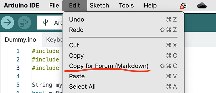

To insert code tags you can either add them in the IDE or use the ` icon above.
 ![Screenshot 2025-07-04 at 17.59.56](https://europe1.discourse-cdn.com/arduino/original/4X/f/5/e/f5e079b61e394d33baa8a0b66e95a9666e107845.png)
