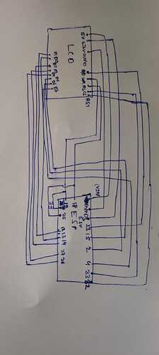

To obtain further help, please follow the forum guidelines and post a complete schematic. Please read:
You need to know, not guess the connections

I'm still waiting for a wiring diagram...
here is the wiring diagram..
in whiteboard

finally got this working....
FOR ESP32
for many of you looking for solution to the same problem in one spot there you go..
for the connection follow this
#define TFT_CS   33
#define TFT_DC   15
#define TFT_RST  32
#define TFT_WR    4
#define TFT_RD    2
#define TFT_D0   12
#define TFT_D1   13
#define TFT_D2   26
#define TFT_D3   25
#define TFT_D4   18
#define TFT_D5   19
#define TFT_D6   27
#define TFT_D7   14
make sure you have the same in the User_Setup.h
for the touch library i am using Adafruit_TouchScreen-master
in TouchScreen.h you have to do the following modifications
#define ESP32_WIFI_TOUCH
make sure you uncomment this in this configuration else your X Y values will be constant
you need to connect pin 39 of esp32 to pin D4 and pin 35 to D15
#define ESP32_WIFI_TOUCH // make sure you uncomment this

const int XP = 27, XM = 15, YP = 4, YM = 14; // default ESP32 Uno touchscreen pins 33 32
TouchScreen ts = TouchScreen(XP, YP, XM, YM, 300);

by this point you will be able to get some values of X Y and Z
use those values to locate the touch and make your UI accordingly....
ps:- this is a work around cause i dont have time do this the correct way (by putting them in getx_y function getting a mapped value of touch......)
