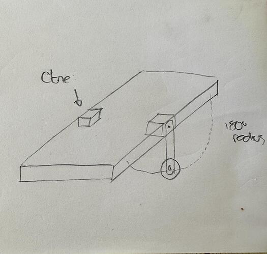

I am not using the stepper motors to build a CNC but I will use all Four Axis. X and Y will Mirror each other and Y and A are cloned and will be mirrored. I am learning as I go and have very basic fundamentals of programming my question is how do I control each motor and how to I govern how far it rotates ? using Arduino IDE, I have used GRBL and proven that they are functioning. what are the basics for defining the ports and then telling them what to do?
Question Three:
I cant find how to calibrate a Stepper motor with out being mounted to something that moves in mm, as I said I'm not using it on a CNC rig so I cant test it mm on Degrees... does anyone know how to calibrate a stepper motor as it is with out being attached to something?

My issue is I don’t have a way of making something move left or right I only have the ability to move an object around the spindle so I need to use degrees not mm.
I hope this makes more sense now.

im not using either i will be using Arms with rollers on the end to make it move on a flat surface
Just to repeat you don't need to calibrate! For all intents and purposes a 200 step per rev motor will move 1.8 degrees per input pulse (for unity microstep ratio) as closely as you would be able to measure it.
Sounds intriguing, how about a drawing and or picture?
well, pulley, do you know its diameter?

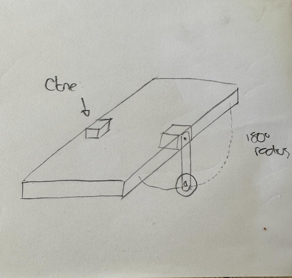

As you can see from my very detailed drawing, some imagination is needed.
Imagine a piece of rectangle material with 2 steppers motors mounted on the long side, mounted on the under side attached, both following the same movement.
attached to the stepper motor is an 'arm' and the other side is a roller for it to roll freely along the surface.
this will either be self explanatory or open a can of worms.
thank you in advance for any help.
i see. it really needs no calibration. just 50 steps times microstepping(probably 16) value equals 90 degree rotation. but at the end of moving area it must be some fixation to hold the arm when stepper disabled.
Leave it enabled with no step pulses, it'll hold itself.
