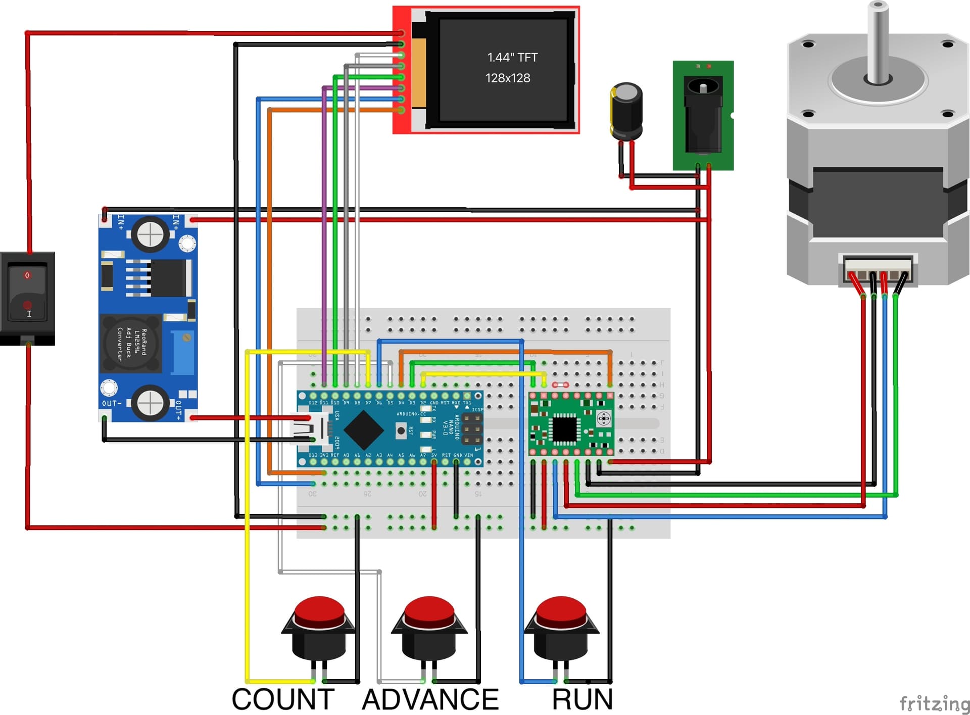

NEMA 17 stepper with 2 buttons for separate run functions, struggling with conflicts
Frequent visitor, first time poster. Appreciate all the topics and help out there. I'm generally new to Arduino, though I've completed a few successful projects so far. This one is stumping me.
I'm making a motorized winder with a NEMA17 stepper and A4988 driver which defaults to 31 turns, but can be increased to 100. I have 3 buttons:
  • run (executes the desired number of turns, a second press during the run cycle aborts the process and resets the count)
  • advance (meant to turn the motor about 30rpm or 100 steps/sec while it's being pressed only)
  • count (this increases the turn count before wrapping back to 1 after 100).
I also have a TFT showing basic turn cycle info: number of turns and "complete" or "abort" when motor stops.
I'm struggling with the advance button. I'll spare the long winded version and post what it's doing now - the closest I could get. In this version, two things are happening that should not happen:
  • advance turns about 10rpm
  • advance interrupts run if pressed during the cycle and stops/aborts.
Here's my setup (note: at this moment, screen switch is bypassed, buck is bypassed and board is powered direct from laptop)

Please post a correct schematic diagram. Fritzing diagrams are frowned upon, as they are usually misleading, difficult to interpret and often wrong.
A laptop cannot be used to power a stepper motor.
Finally, if the switch is intended to power down the display, this is a bad idea. Connecting a powered MCU to an unpowered device via the I/O pins can damage one or both devices.
what's this?
why not simply
    advanceMode = ! digitalRead (ADVANCE_BUTTON_PIN);
Thank you. I do not have a schematic. Thank you for the comment on the switch. It's currently unused and will remain that way moving forward.
The laptop is powering the board. 12v to the driver.

A mistake from a previous attempt to pull out the advance and test it and return it. thank you for catching that!
Fritzing can produce one of poor quality, but pencil and paper work very well.
Thanks! that does simplify things. I tried this, with new behavior: Advance still creeps at about 20steps/sec. Now when pressing run after advancing, the motor jitters back and forth for the duration of its cycle.
