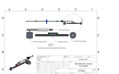

@Robin2 The motor is used on a belt driven linear actuator which only takes 1.5 rotation to travel its full length. Hence why I need a short acceleration distance.

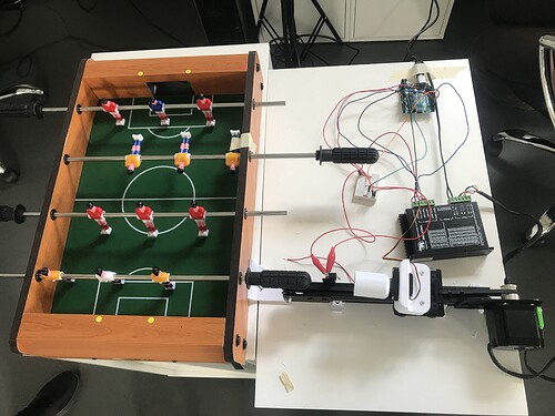

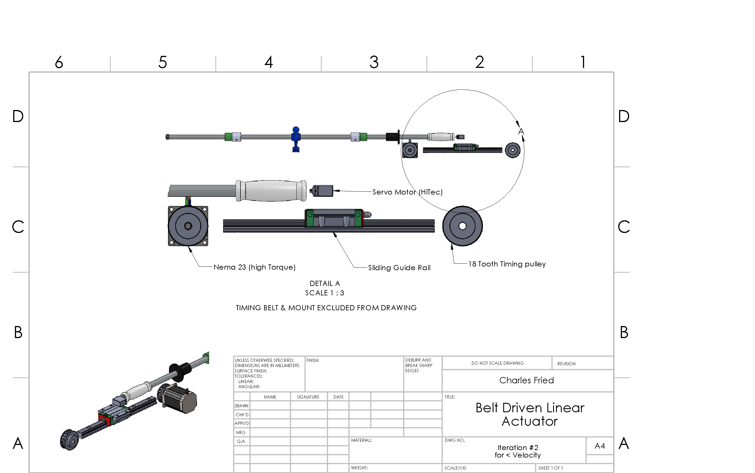

@Robin2 After some more research it seems I need to go with a DC motor.
@MarkT I've attached some pictures of my current setup, here's also some values as I understand them:
All the parts included in the linear movement weight approximately 400gr.
In the worst case scenario I need them to move 5cm within 30ms, or a speed of 166cm/s.
Given these figures can someone point me in the direction of an appropriate DC motor?

0.4kg move 5 cm in 30ms?? You need a huge voice-coil motor, nothing else has a hope.
You need an acceleration of 222m/s/s for that motion, so a force of 90N minimum, 150W minimum...
Lets do the maths:
Accelerate from standstill to Vmax and down to standstill again in 0.03 seconds, ie an
acceleration ramp followed by a deceleration ramp, each being:
s = 0.025m, t = 0.015s. 2 s = a t^2
Thus a = 222,
Vmax = a t = 3.33 m/s
KE at max speed = 0.5 m Vmax^2 = 2.22 J
power to accelerate on average = 2.22 / 0.015 = 148W
force = m a = 90N
I think you neglected to allow for the huge requirements of rapid acceleration - table football
is a real work out, know you know why...
