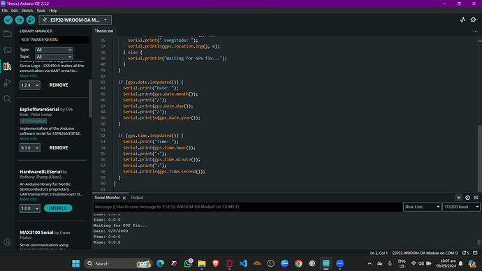

Hello everyone, i have a NEO-6M GPS Module and using ESP - WROOM 32 for the microcontroller, and i cant seem to receive GPS data but i do have a Time and date received but it is all at default (Time - 0:0:0:0 ; Date - 0/0/2000) and for the GPS data, it only prints "Waiting for GPS Fix"

      Serial.println("Waiting for GPS fix...");
  if (gps.date.isUpdated()) {
    Serial.print("Date: ");
    Serial.print(gps.date.month());
    Serial.print("/");
    Serial.print(gps.date.day());
    Serial.print("/");
    Serial.println(gps.date.year());
  if (gps.time.isUpdated()) {
    Serial.print("Time: ");
    Serial.print(gps.time.hour());
    Serial.print(":");
    Serial.print(gps.time.minute());
    Serial.print(":");
    Serial.println(gps.time.second());

Hello! This is what the output looks like:
$GNGLL,,,,,,V,N*7A
$GNRMC,,V,,,,,,,,,,N*4D
$GNVTG,,,,,,,,,N*2E
$GNGGA,,,,,,0,00,99.99,,,,,,*56
$GNGSA,A,1,,,,,,,,,,,,,99.99,99.99,99.99*2E
$GPGSV,1,1,00*79
$GLGSV,1,1,00*65
$GNGLL,,,,,,V,N*7A
Ln 20, Col 2
DOIT ESP32 DEVKIT V1
on COM13
The 'V' indicates "no lock". When locked, that will change to 'A'.
The GPS cannot see any satellites.
Its either not outside with a good view of the sky or the GPS or antenna is faulty.
