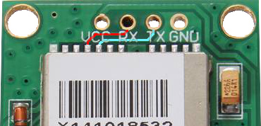

@ /dev:
there are GY-NEO-6M V2 modules available which are 3-5 V compliant:
I have one and I'm running it successfully both on a Mega and on a Due.
It has a 3.3V regulator, so it should be powered by 5V, but it does not level-shift the TX and RX lines, as you can see on this photo from the seller's listing:
The ublox documentation clearly states that 3.6V is the maximum input. Although the TX output is marginal WRT to Arduino input, a direct connection from the Arduino TX ouput applies ~4.7V to the GPS RX input. At a minimum, this pin will draw more current, decreasing battery life. At the most, it will increase the operating temperature and eventually damage the RX pin.
Rather than rely on anecdotal evidence, just add a few resistors and operate within spec, SAFELY.

P.S. That doesn't look like a real ublox GPS, so I wonder what its input spec is...
do I understand you correctly: do you mean my device is not the original ublox GPS?

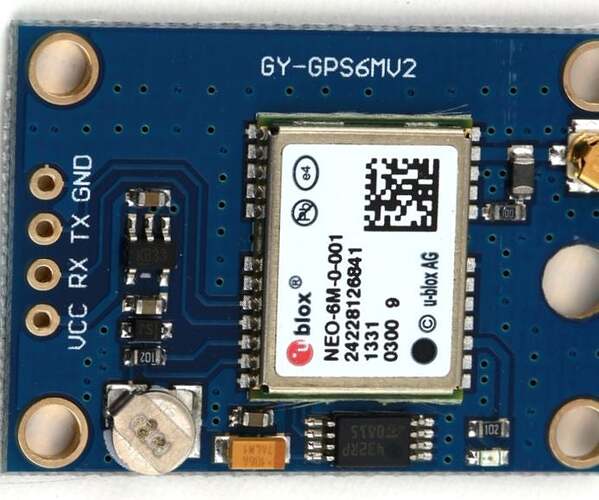

If your module just has that barcode on it, it doesn't look like a real ublox NEO-6M. It may be "compatible", but it doesn't look "genuine". Google shows a bunch of modules with the specified label, unlike yours. Instead of "PPP-GV-T-XXX", they say "NEO-6M-0-001".
It may be working fine for you, I'm just pointing out that the Electrical Specifications for your module may be different from a real module. The ebay listing just says "Power supply: 3V-5V", which makes sense, because there is a 3.3V regulator/battery charger on board. It does not say anything about the RX/TX signal levels, and they are directly connected.
If you really want to know if it's stressing your module, you could measure how much current is going into the RX pin. If it's more than a fraction of 1mA, that would tell you that the pin is sinking current, probably through the typical input protection diodes. This would mean that the input pins were not designed for a 5V logic input.
For comparison, you could use a resistor divider to scale the input voltage down to 0V-3.3V, and measure the current going into the RX pin from the divider. At 3.3V, it should be microamps. However, most people, including me, do not have the equipment for measuring currents that small. So I just use a level-shifter and call it done. :slight_smile:

unfortunately I can't measure current.
But what a f***ing crap if they say 3-5V compliant and then the levels are not shifted accordingly!
Many people have reported the same success. It might be ok, even though it's out-of-spec. Of course, we don't really know the spec for that module.
