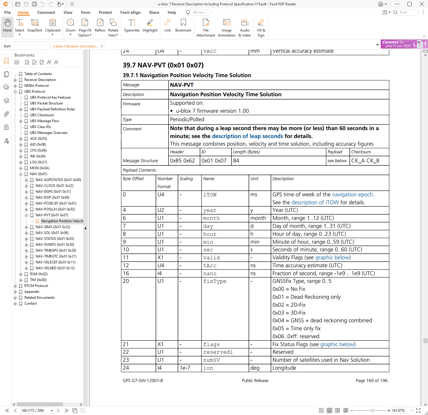

I just use the UBX output and can't think of any sattelite information that NMEA would provide, that you can't get via UBX.
With an M8N you may only need the NAV-PVT word, to get your position, speeds and indication of signal quality
The sparkfun library has PVT examples
